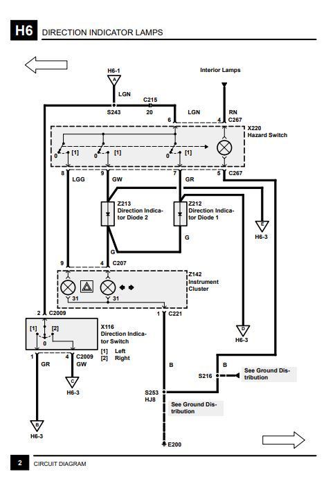

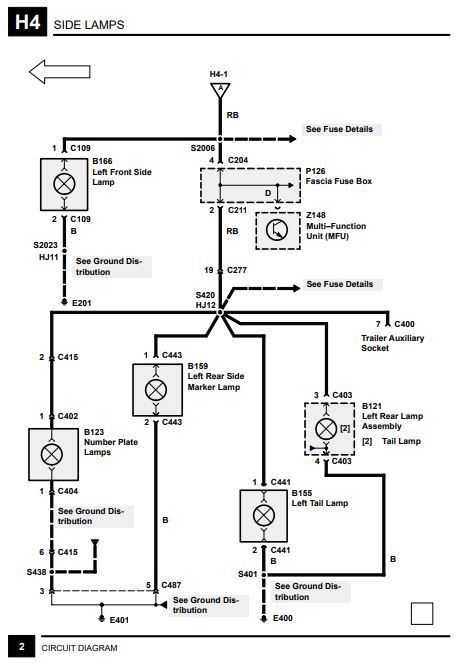

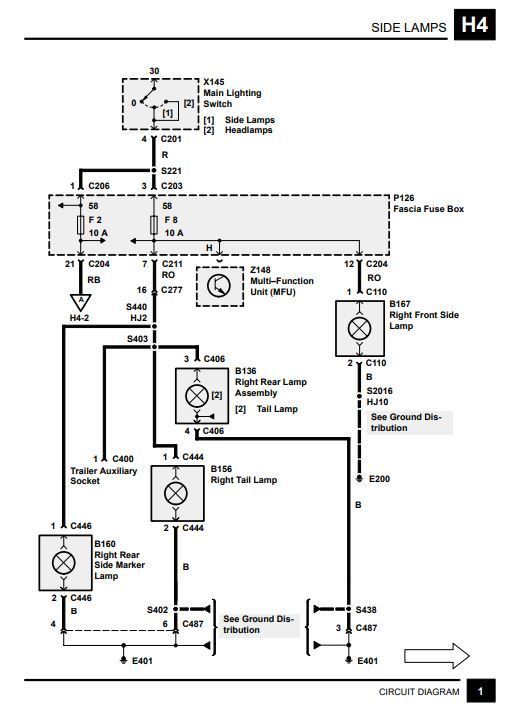

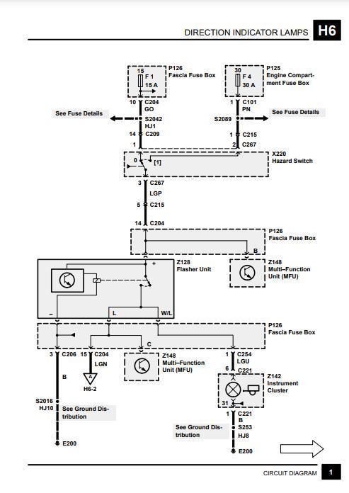

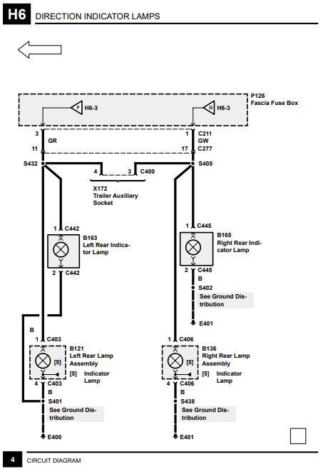

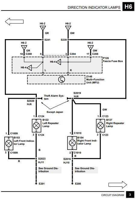

these are the schematics for the direction indicator lamps(turn signals)

You probably already know this, but if none of these lights work, then check for power at F2 and F8 (upstream side). If no power, then check further upstream of the Main Lighting Switch (look in the power distribution section to find the fuse feeding the switch).
I did not see the turn signals in the diagrams, only running lights. Can you find the turn signal diagram? That's probably most important.
