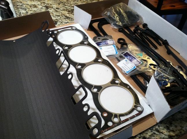

I'm more confused as well. Photo you posted earlier of gasket shows 10 bolts. Page shows HG for 14 bolt engine, a 3.9. Suffix B used a different thickness gasket. So which block do you have? 3.9 or 4.0?

I'm more confused now, so 66 was selected based on the 3.9, which matches the old sheets from RAVE. They start with 60 newton meters (44 ft pounds), then 66 and 66 foot pounds.
I'm not sure how that translates to 15 newton meters (20 foot pounds) and 90 degrees and 90 degrees (overhaul book for 4.0). The overhaul book doesn't mention ending torque by specific number.

I suspect that the rev up simply made the problem show up sooner, not cause it. What seems to be a question now is could you back off bolts, and re-torque, without removing heads, and/or without buying new gaskets?
