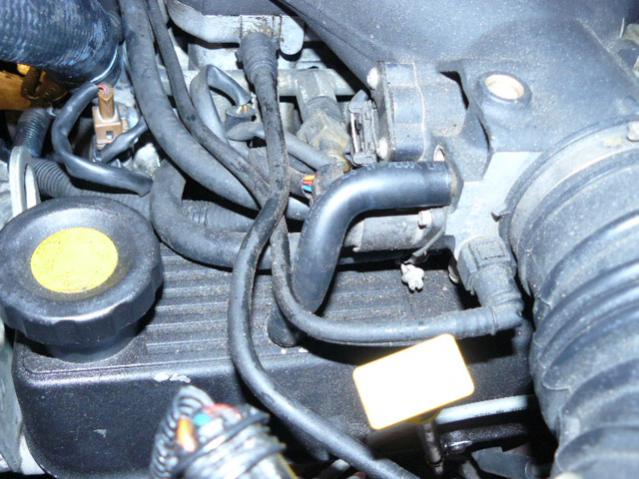

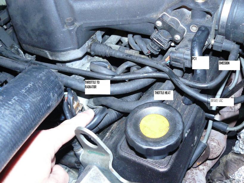

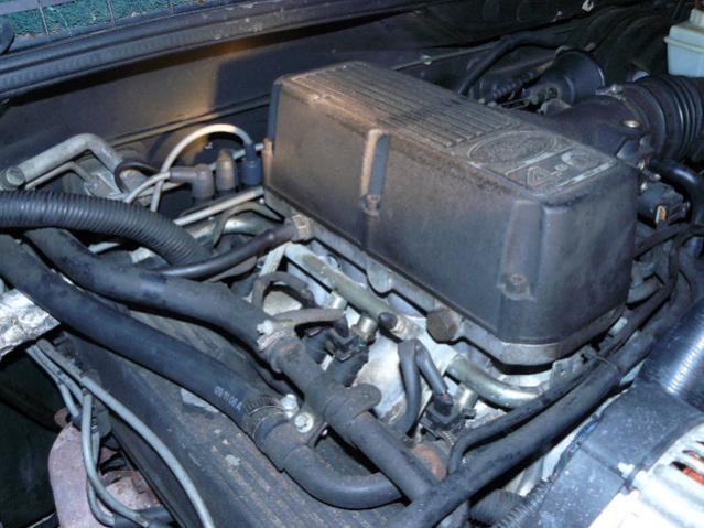

Here's some pix that may help.
To the right of thermostat - plug with brown top is two wire coolant temp to ECM, single wire to left of it is temperature sensor for gauge.
Finger points to feed side of hot coolant to the throttle plate heater. Text added.
Same items, view from driver's fender.
View of far side of intake, line runs intake to top of valve cover, oil separator connection.
