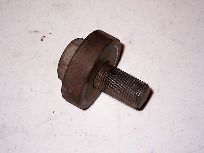

The crank pulley has a bolt with dished washer behind it...
Checking back in after a couple of weeks...
In regards to the crank pulley bolt and washer, the first photo is what I have. The only reference to a dished washer I could find on the interwebz was a replacement for the 200TDI that I found on a British site for Rover parts, and mine is a 4.0 V8. The bolt and washer I have is torqued to 200lbs as recommended and there's no forward movement of the pulley, but if this originally came with a dished washer and needs one, where can I get it?

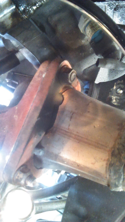

1) There's an exhaust leak on the passenger side where the pipe meets the bottom of the pipe flange bolted to the manifold. Seems to be a neat crack and broken weld(s). I used a hand-held mirror and flashlight to highlight the area for the photo. You can also see the smoking gun: exhaust carbon buildup at the bottom of the flange. I'm in California and would need a CARB-legal cat assembly which is $600+ and hard to find. In lieu of that, would JB Weld work as a temporary solution, and if not, can I pull the assembly and use a torch and some nickel weld on it? Either way, I need to get it handled asap with kids in the car every morning and driving with all the windows and sunroof open.

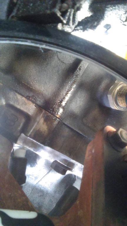

2) The third photo is what I discovered as I was inspecting the exhaust... looks like a head gasket leak? It's the only leak I found on the left and right gaskets, and there's also a mild leak from the timing cover. The coolant is clean and there's no loss of coolant or white smoke or anything else indicating a blown gasket, but still...

Starter turning but not engaging the flywheel would be the starters pinion not extending into the flywheel. I would remove it and check it, probably wearing out. I wouldn't worry about the dished washer, if it's fixed let it ride but do keep an eye on it. Downpipe flange, let a muffler shop weld it (or you if you have the equipment). They can tack it in place and then run a bead or two all the way around it while off the manifold. Hard knock...... can be crank bearings (spun bearing - hopefully not) or worn piston pin, hell, could even be timing chain slack. If nothing is tapping the crank sensor your reluctor ring escapade is successful, double check the tabs to be sure they're straight and even in between one another. To be honest the sensor is looking for the missing tab(s), the long gap, not the existing tabs.

I swung by the local muffler shop yesterday to see about having the downpipe welded, but the shop was closed. Hope they're enjoying their Labor Day weekend and I'll check back with them during the week.
