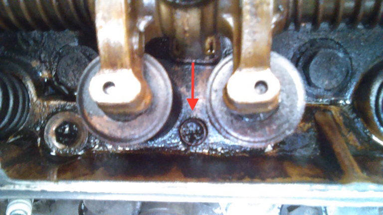

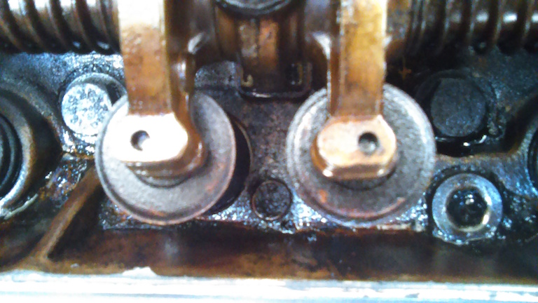

Originally Posted by ihscouts
I'll bet a brewski that you'll find the rocker shafts and rockers themselves near full occlusion with baked oil and sludge.
Do ya think??? Here's the passenger side rocker at #4 and #6 cylinders (first and second photos, respectively). Am I correct to assume that the two larger holes below them are oil ports? And the two smaller holes at the bottom between the rocker arms--one of which is arrowed--ports or return ports as well? If so, they are packed to the brim with sludge. And I haven't even pulled the rocker assembly yet. So what kind of brewskis do you like?

Not so fast. Those are not for drainage, casting plugs and casting process leftovers. Drainage is up top, down through the push rod area....... I do see carbon though, on the valve springs and floor of the head. That is like sand paper to these engines before it makes it's way back through the filter. The rocker assembly must be removed from head and then disassembled to check rockers and shaft. Almost there........ It's takes several years to create the carbon. Mine looked much worse.
Right, okay. Just finished the rocker and there was definitely carbon in there. Shafts had a little bit of wear but arms and springs were good, pushrods were straight and in surprisingly good shape. Cleaned up the assembly and torqued it back on. Looks a heck of a lot better now. Also cleaned around the valve springs and inside the head. Quite a bit of carbon in there as well.
