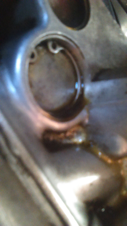

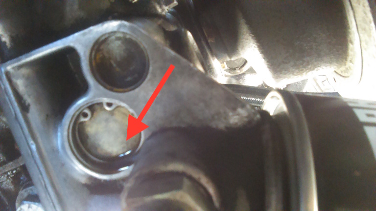

I pinpointed the source of the leak. It's not coming from the edges of the cover through the RTV, it's coming from an indented "cap" on the cover itself just above and behind the filter. The "cap" has what looks like a c-clip retainer around the edge. This seems to be the only leak coming from the cover, and it's not coming from anywhere above this point. I know because I wiped everything down thoroughly and watched for the oil to reappear. Photos are below.

Oil pressure by-pass valve....... That should be an easy fix. Heck, just remove the circlip and it should push out the plug with spring pressure (might have to tap it a couple of times). They use an O-ring to seal this plug - hardware store item.

My first thought when I looked at it was: c-clip = removable = easy fix. Done. Thank you.

Bitch to get back in, and yes oring, don't go to fat on boring and lube it
