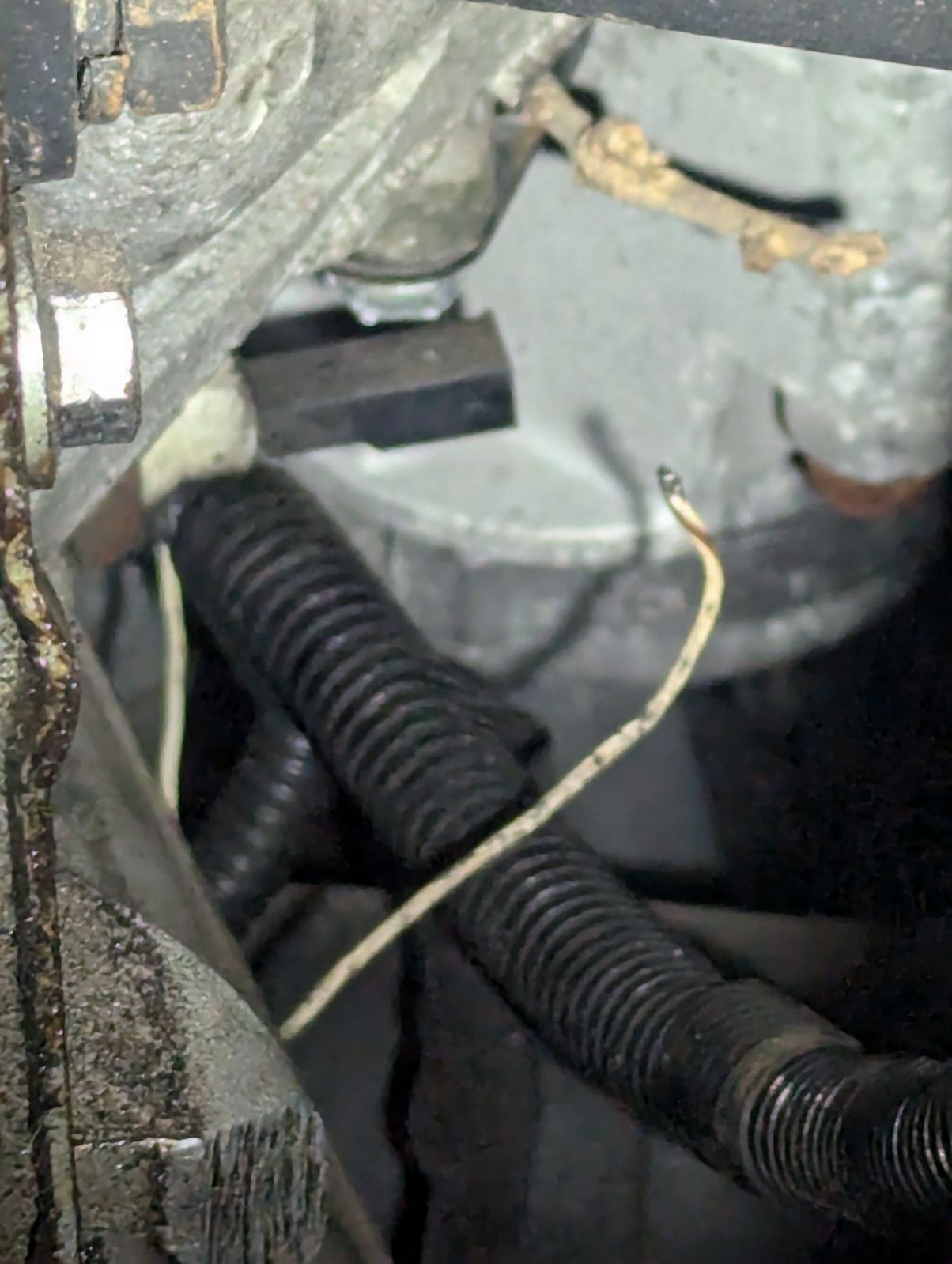

While crawling under the vehicle searching for issues I found a single wire connector (white wire red tracer) broken away from the black female plug at the front of the engine. I am not sure what this is , crank position sensor? Picture is attached. I plan to repair this just ran out of time.

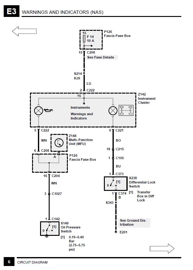

Given the location near the front of the engine I suspect that wire is actually a white with BROWN tracer (easy to take if for a worn red tracer). That would be connected to connector C142 at the oil pressure switch which is located on the front (timing) cover close to the oil filter.
The electrical diagrams can be found in the google drive in my signature. FWIW, initially I searched for "WR" to find all the white/red wires. Then it dawned on me that it could be a "WN" wire. After that the search took me right there.
You can find it in the document: etlj970x - electrical.pdf . Chapter E3, page 6.
I'm not certain this is fix the 'no crank' symptom, but it might.

Thank you for the diagram, I will get this repaired and try again. Based on the diagram it looks like it just triggers the dash light

That oil pressure switch wire does not prevent cranking, although the broken wire does indicate as if oil pressure is good (normally closed switch opens when pressure is applied).

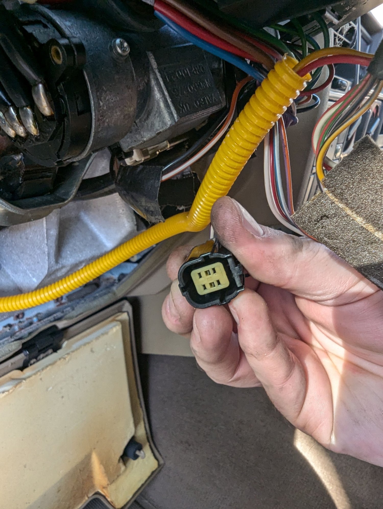

Also new discovery, I pulled the steering column shroud and found this plug not connected to anything it's just zip tied to another harness. Any idea what it is?
