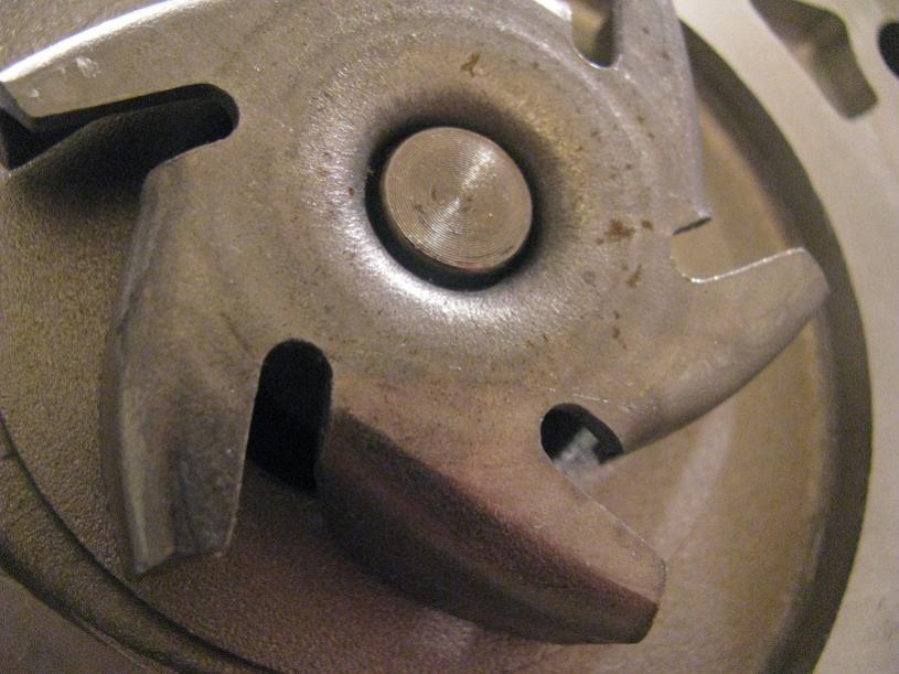

On the water pump, a known failure mechanism is the impeller is staked onto the shaft. It becomes loose and does not effectively move the water. While you have yours out, you may want to take a close look at that aspect of the part.

Took some pics of the old and new water pumps impeller areas for ya.
