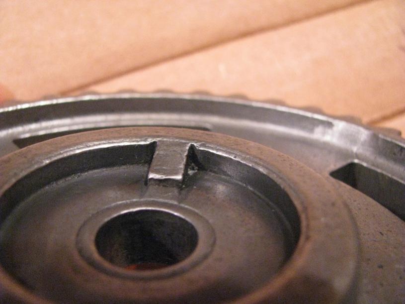

New gear left, old right. New is from British Pacific, Allmakes brand, unknown manufacturer.
It fits on much tighter, there were bits of casting material or something left in the corners, and the key is a bit too wide so that it actually chiseled out the keyway on my cam putting it on. It has a dark grey, slightly pitted, slightly uneven, but very smooth surface. They good part is it seems very hard. They key showed no signs of wear even after being hammered onto the cam, and it completely resisted my attempted grinding with a stainless steel wheel.
Attached Thumbnails New vs Old Cam Gear Pics-img_1817.jpg   New vs Old Cam Gear Pics-img_1818.jpg   New vs Old Cam Gear Pics-img_1819.jpg

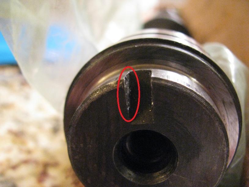

Pics of fitment consequences to cam.
Attached Thumbnails New vs Old Cam Gear Pics-img_1821.jpg   New vs Old Cam Gear Pics-img_1822.jpg

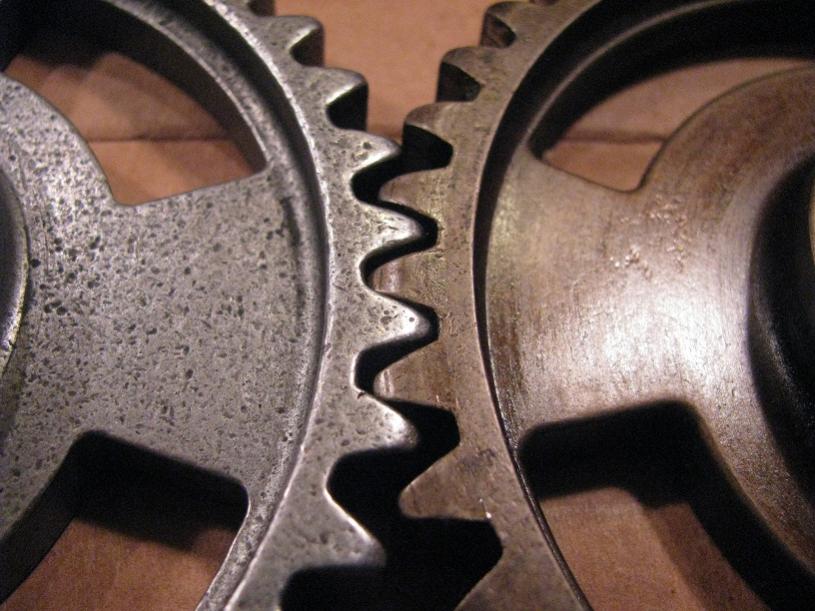

Teeth shot.

Gear teeth - cast on left, machined on right? Seems like machined might be a step up, more precise?

Same order, new left, old right.

Hummm....that cam gear in cast isn't the business, hence the issue with the cam. The scratches on the cam should be an issue. I just hope that gear doesn't fracture down the road.
