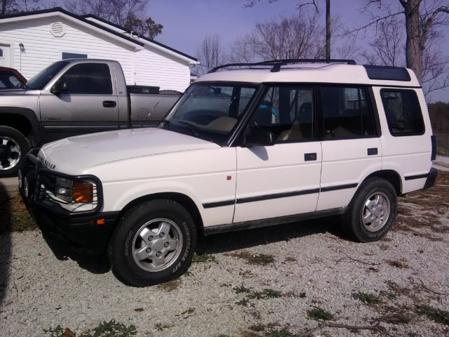

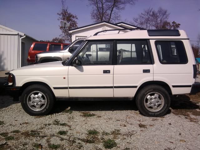

I am pretty sure the lifts on ebay are from Underground and the medium 2" shows out of stock on the website. Here is a pic of the Discovery that I bought for this build
