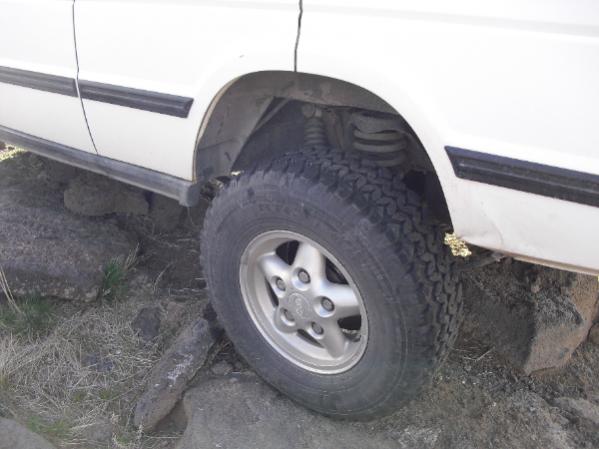

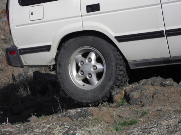

Anyway articulation is fine. Disconnect the sways if you need more. This is with sways still on, and I still had enough flex to go up and over that rock on the right side. I have since had to trim the rear fenders on both sides though...
Attached Thumbnails Beginning Disco Build-Up, where to start-cimg1434.jpg   Beginning Disco Build-Up, where to start-cimg1432.jpg
