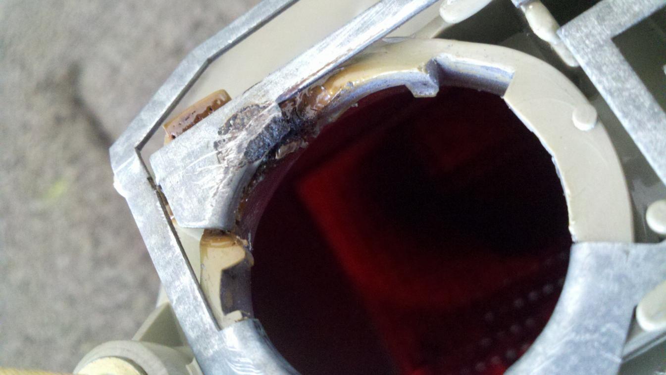

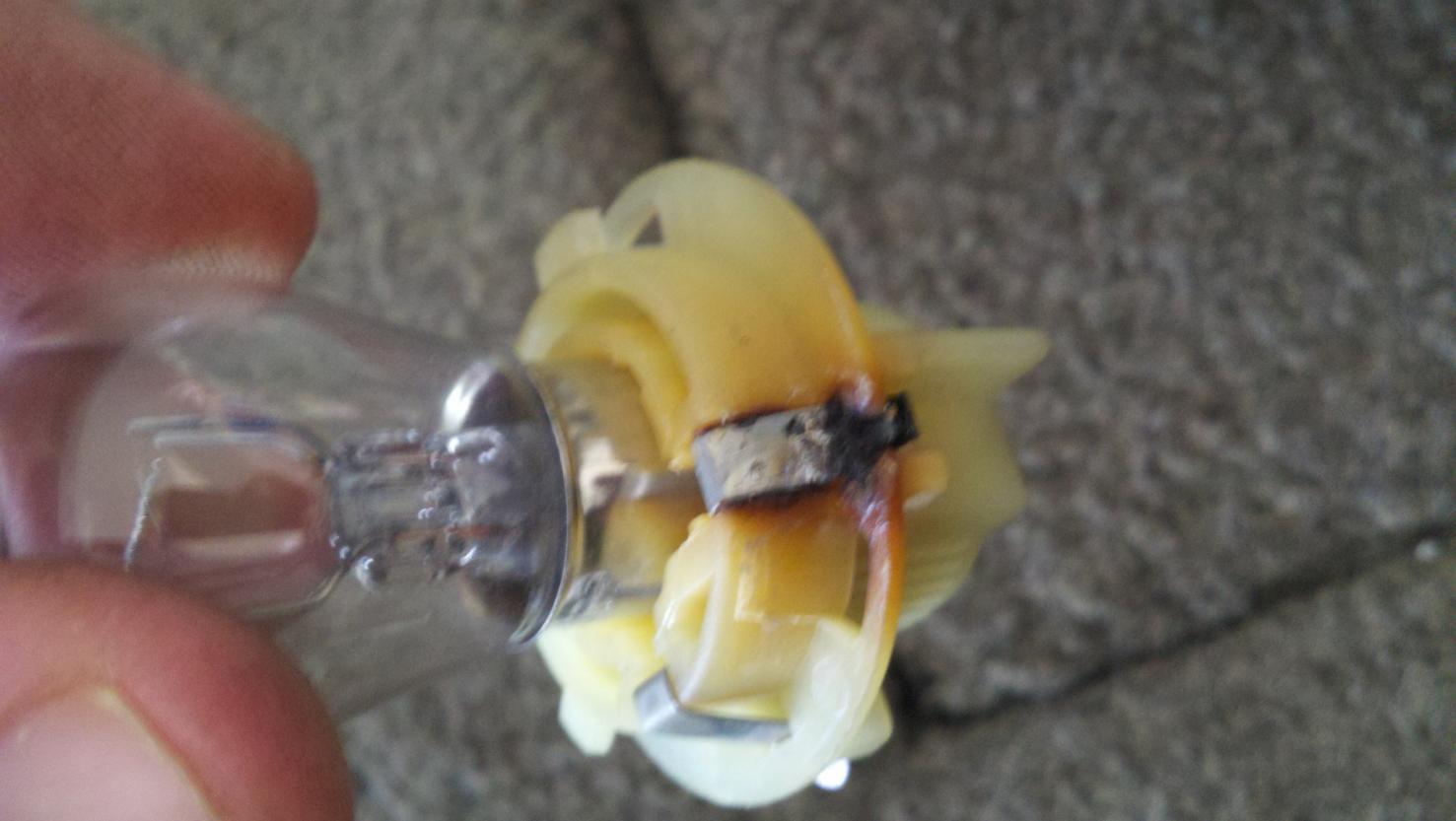

UPDATE, YAY FIRE! ok so i might have found the problem, i have yet to check the drivers side one but the passenger one shows what appears to be fire damage. see pics
It looks like it shorted if anyone has anyother ideas let me know.
Im headed back out to the driveway to test to see if it even works anymore.

That is definitely an overheat condition. I seem to recall seeing something about the taillights tending to short out on these but do not recall any specific details. Did you try a search on brake lights?

yes i did try seaching, I finally just took at to the wrong place, the bulbs that were in there were different from the ones listed on the socket plug, and those numbers were all different from the stores computer.

I do recall that people suffered damage from the trailer plugs, don't know if that is associated with your problem or not. If it were me, I would call Paul Grant/Will Tillery and see if they have any tail light sockets available and go ahead and cut off those screwed up ones and replace them. Can't hurt.

problem fixed, PO had just thrown some random bulbs in , they were drawing to much. That caused the bulbs to over heat or short out the circut or something and create enough heat to burn and melt the plastic....Solution clean off metal surfaces, replace with new correct bulbs and now I have all my brake lights again. for now.

Great. Also note that "proper" bulbs have oval shaped contacts on the bottom, instead of round ones on most bulbs.
