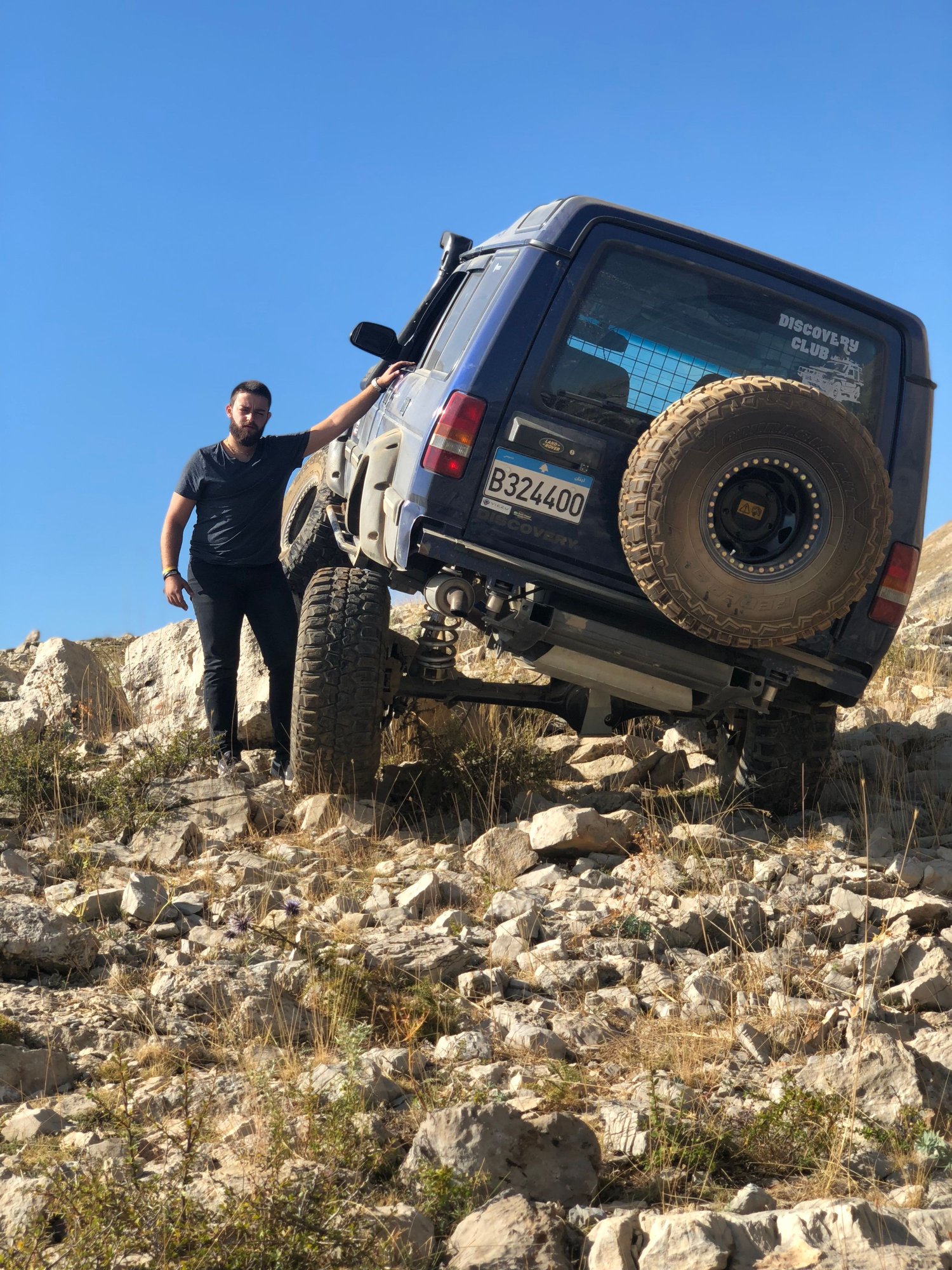

please i need yr help ! i have the discovery 1 .... terrafirma full kit is placed ! 2” body lifted and 2” spring spacers ! the suspension is the lomgtravel 2+” by terrafirma ! i should place extended bumpstops for my 35” tires ! so any calculations are requierd ? please

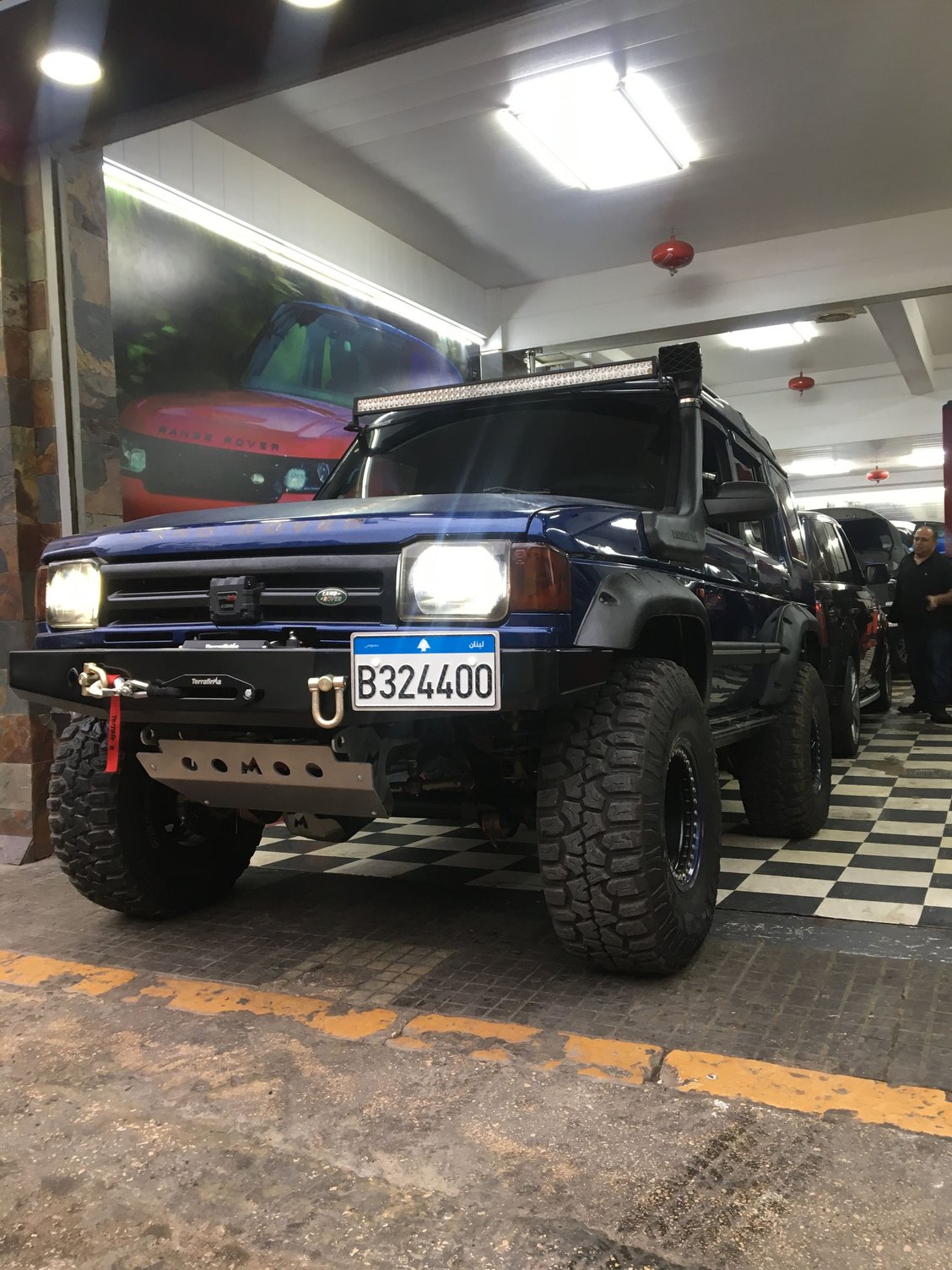

Curious...what is that device attached to your grill?

you should of measured for your self while you had your Disco perched on that rock. Its pretty simple, just stuff your tire into the wheel well and measure the gap between bump stop mount to impact location. Confirm your shock isn't bottoming out and add a couple inches for extra travel for when the bump stop compresses.
Thanks!
Looks like a remote mounted winch control box....
