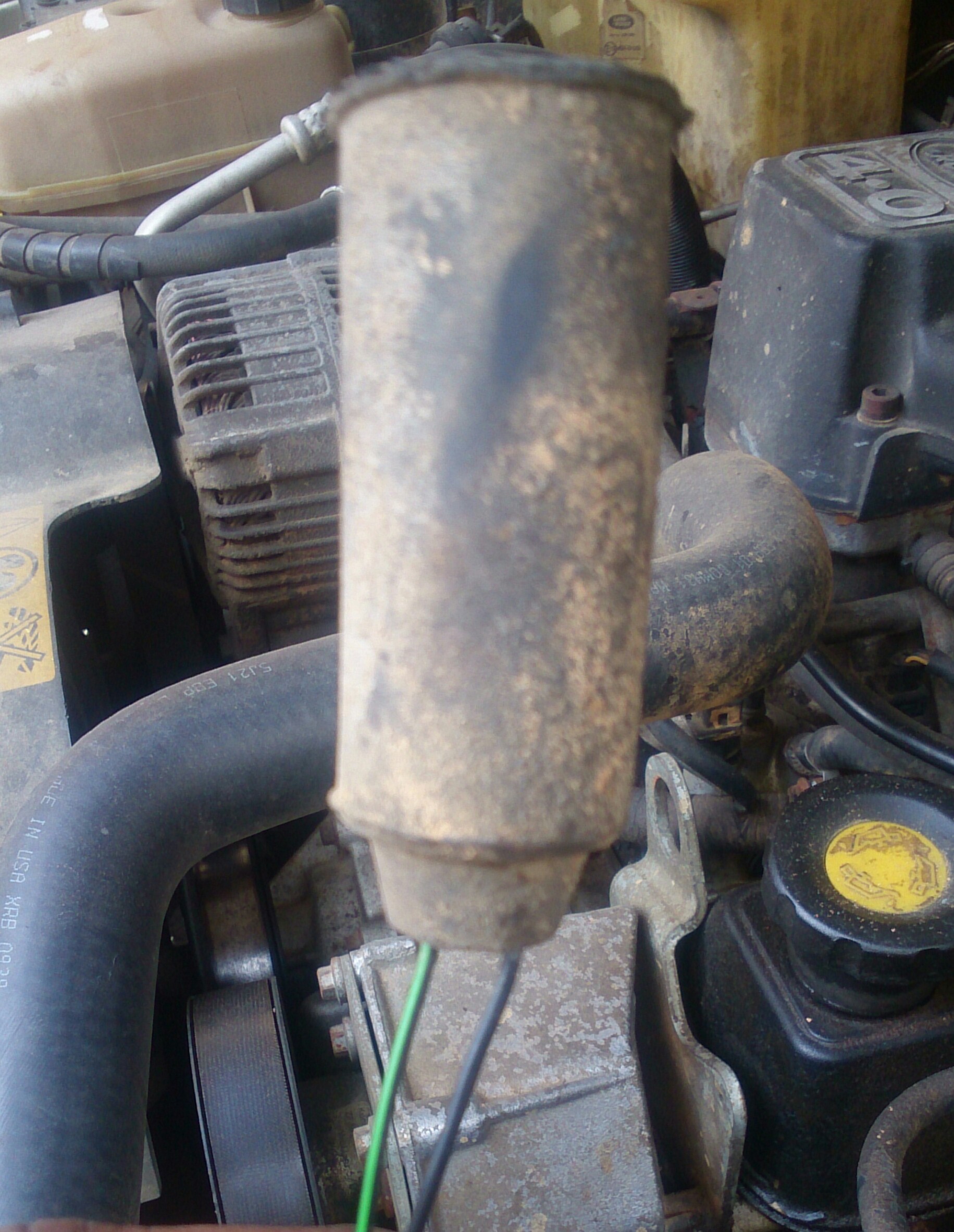

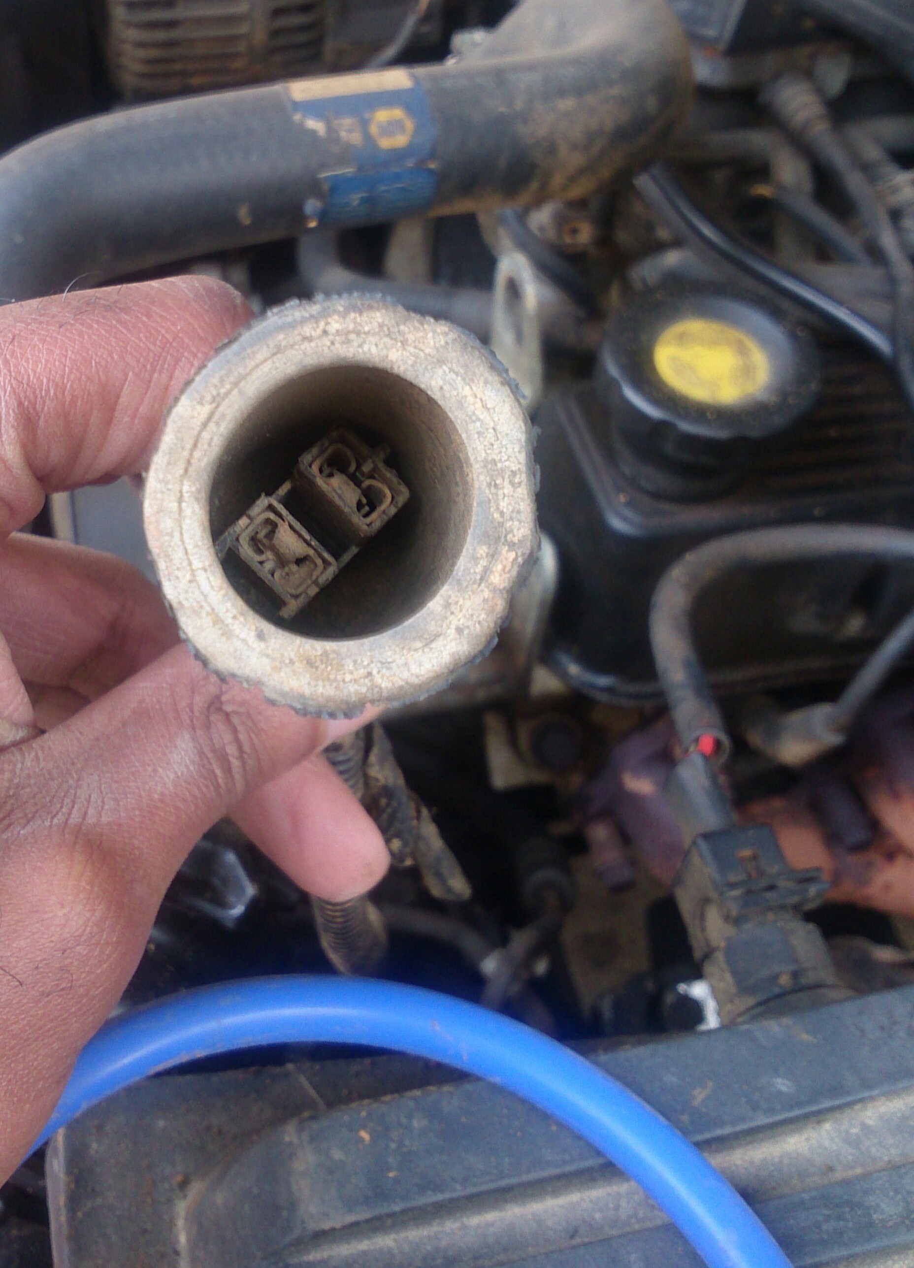

Hello Good People,
Can some please help identify this connection that is in the same area as the cruise control electric connection(under the the bottle jack)
T.I.A.

Transmission cooler line temperature sensor. Between steering box and radiator

Thanks RedRovin!
Its not connected to anything..YIKES!

You're Welcome. I believe its more of a safety switch than anything. Truck can run fine without it, but you wouldn't know if the trans cooler malfunctioned and started overheating the oil.

Okay I see.
So its been unplugged since I had this rig.
If properly connected would this display some light on the gauge cluster?

Only if your transmission has been over heating.
