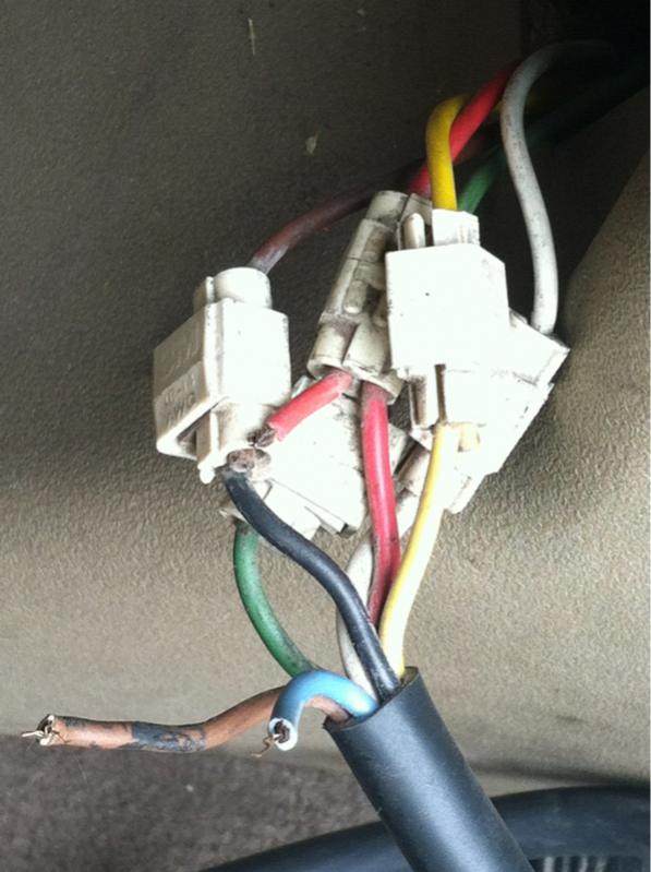

This is from the right rear corner behind tail light. Every thing seems to be working. Only thing I've not used is trailer plug...

You are in trailer socket land, the RAVE electrical manual is your friend. The pictures in the RAVE show C400, C424, and C425 stowed in that cavity behind the tail lamps and cargo light. Page 505 of 591 in the 97 electrical manual.

iircc that is the spot where trailer harness is wired, from. looks like po sloppy diy trailer light mod attempt.
