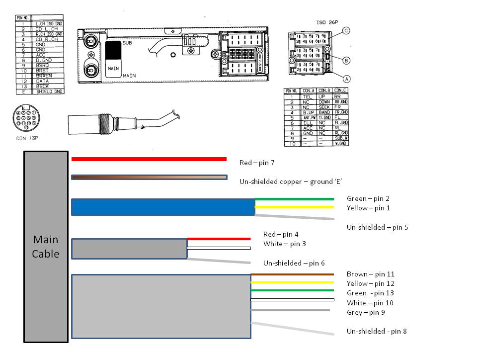

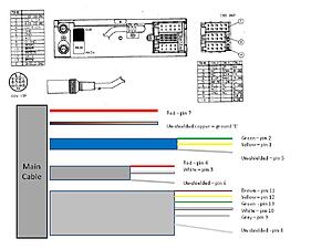

ditch the cassette. If your CD player powers up, all you need to do....
1. snip the audio wires (Left +,- & Right +,-),
2. add a female RCA to the wires going to the head unit,
3. install a Bluetooth adapter such as https://a.co/d/02iM76Y5 which can be installed behind the window switches (there is a ton of room under there) or under the passenger seat on top of the CD player,
4. tap power from the cigarette lighter or the CD
listen to perfect digital music streamed from your phone.
The main cable between the factory head unit and the CD player has 13 wires in it (plus a ground). Using the diagram we see that pins 1,2,3 & 4 carry the audio signals.
1. Left channel ground
2. Left channel positive signal
3. Right channel ground
4. Right channel positive signal
Put the female RCA connection along wires 1,2,3, & 4 to accept the bluetooth module output and fool the factory head unit into thinking it is playing a CD when, in fact, the audio is coming from our new inputs.
The other 9 of the 13 wires carry control codes so I just put jumpers in between them so the CD and head unit can continue to ‘talk’ to each other.
Finally there is the ground which again can simply be re-connected.
Below is the key for figuring out which wire inside the main cable goes to which pin.
Inside the main cable there are two grey, a blue, and a red wire as well as an unshielded ground. The grey wires and the blue wire have wires inside them so in reality you have three ‘layers’ of wire.
