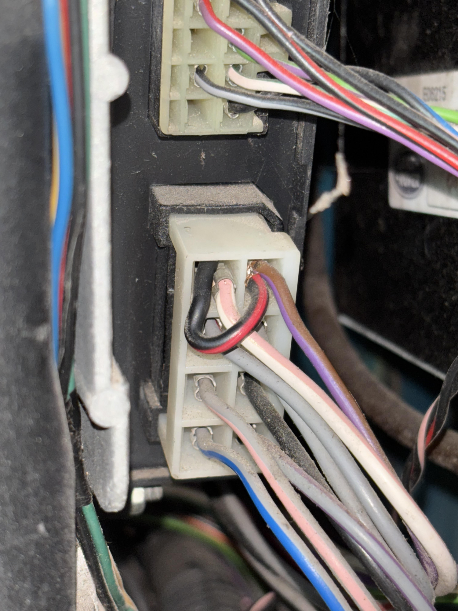

So I did find this jumper cable once I got the glove box out. I was looking for a wire diagram for this but I can't seem to find one. Would this be tapped into the 12V?

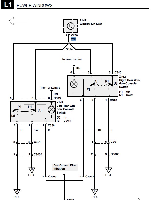

Here's the ETM (Electrical Troubleshooting Manual) for 1997 Disco, 98' should be almost the same. Has wiring diagrams for all systems and info about each connector and part, might help you out.
Try to find which connectors they are based on their location, shape/size, and what they're connected. I've found it unreliable to rely on the wire colors in order to identify the connectors but the indicated colors on the ETM can be used to find what pin is what.

Maybe remove that jumper to see if it fixes the battery problem. The window control module can also be repaired by soldering the circuit board after prying it out of the box. The weak solder joints show up as black circles vs shiny silver.

almost all the manuals can be found in the google drive linked in my signature. Download and use them as you like.
The purple/brown wire carries power from a fuse. jumping that to the white/pink wire allows power to flow constantly to the window switches rather than rely on the ECU to make the decision. (see L1-4.... chapter L1, page 4 of the etlj970x......pdf)
