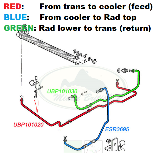

Dumped in sea foam and ran it with no change its sat several days now and im gonna service the trans and i want to flush it, anyone know off hand what line in the radiator is pressure top or bottom , id rather not hose down the garage with trans fluid

TOP hose is the pressure side post cooler. You could get it at the cooler, but it's far less work to go from the Top Rad hose.
Easy to just remove the top trans line (ESR3695) and fit a bit of hose with a clamp to it, or on the adaptor ( ESR1262 ) in the Rad.

Thats what i thought thanks

On mine the fluid came out under pressure from top fitting on radiator not the top line
