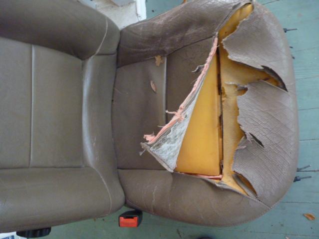

I needed front electric seats for my 97 Disco 1 with 170K, they were trashed by age and PO. Prices on eBay were high (or I am cheap), plus shipping. Checked the salvage yards, and it seemed like when I did find a good seat it was only the passenger. So I took the plunge and scavenged two passenger seats, which were about $25 a piece (U-pull-da-partz).
Removed old seats. Set aside to keep for spare parts (like motors). Not interested in heated seats, live in an area where it gets below 30 four days a year. Of course the "new" passenger seat bolted in just fine. To make a passenger seat work for the driver's side, you need to swap the seat belt and seat belt female end, on mine these used the same Torx bit as was required to remove the two rear bolts on the seats. Also swap out the two plastic trim parts from the original seat. These are held by plastic push in fastners, similar to door trim.
Photos show typical old seat, and results of swap.
The end result is functioning seats, with the driver seat having the lumbar control **** on the left side. It has enough clearance to pass by the door frame. The motor wiring was the same and plugged right up.
I had problems with one of my replacement seats, the motor for the seat back would heat up and sieze after about 10 seconds of use. All four of the motors are under the seat, and they are the same motor. You can feel the cable from each motor and feel it torque when that motor is activated. Easy to replace, the seat cable is like an old style speedometer cable. Some guys may want to spend time greasing that cable, and the right angle gear reducing drives, but before you spend time on that just remove the cable from the motor end and try it with an electric drill. Since your old speedometer cable could go 50K without new grease, the seat cables can probably make it quite a while because of their low number of hours used.
