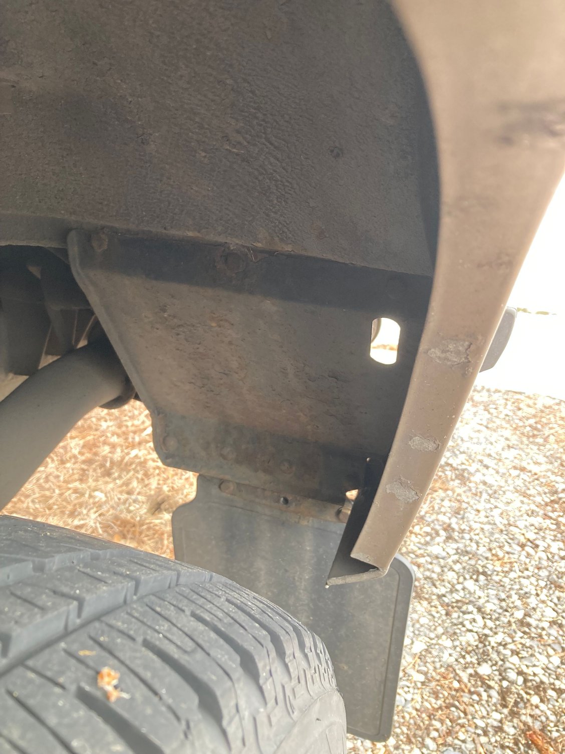

Hi all, getting my 1998 3 door tdi back together is a bit tough in places.
After a year spent replacing the complete rear floor, cross member and most body mounts I'm slowly getting the old girl back on her feet. However, I can't remember how the rear mud flap. brackets fit, its been so long, and the new side sections did not have any holes and I can't find any details anywhere that shoes how they fit. orienting them with the lower rear panel hole - the one that rots, different metal eh - the brackets appear to fit vertically against the lip of the wheel arch that extends downwards, any other location doesn't sit right, the brackets are handed for the exhaust. Could anyone take a look at their disco and advise?
Unfortunately in a fit of madness I sold my v8 5 door last year, the disco1's are thin on the ground now.
Cheers

Here are photos of
Right rear wheel well
Right rear behind
Left rear behind
my 94 D1.

Brilliant, thanks ever so much!
