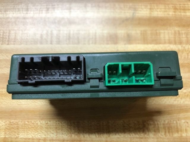

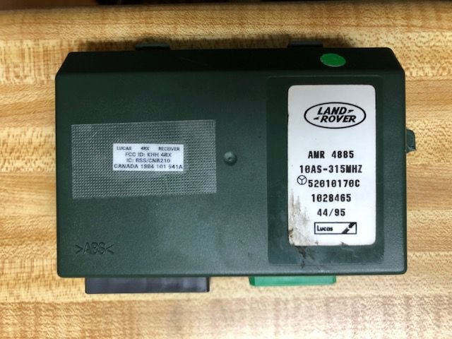

I think this is the Alarm Control Unit?

It tis.
