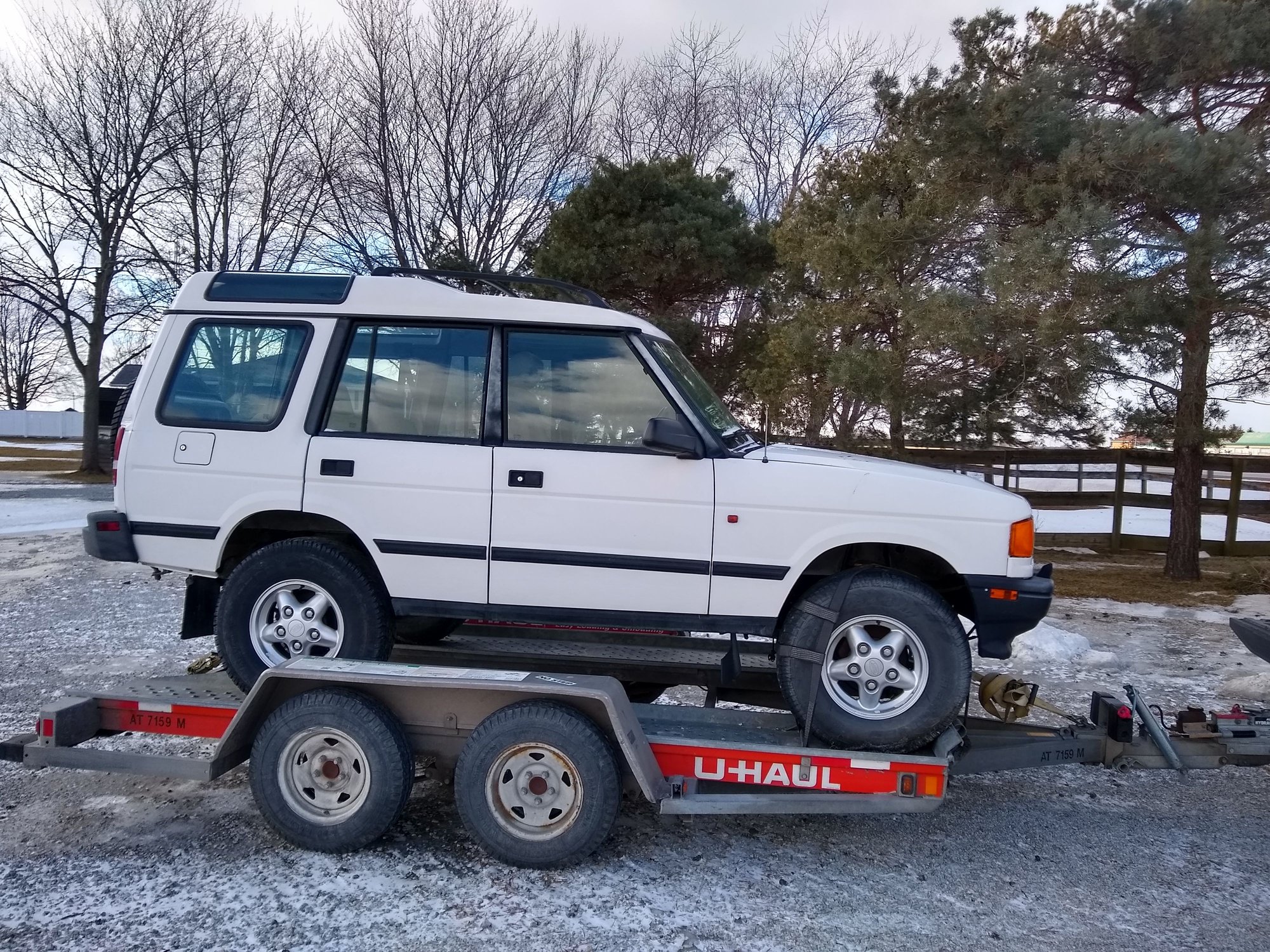

Picking her up from the previous owner, she was left to die behind a barn after the owner couldnt finish restoring it (he bought it as a project truck and then moved across the province)
Sits nice with the lift and tires.
