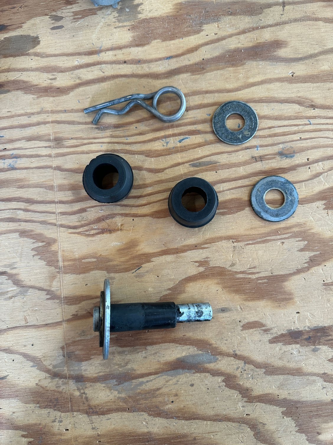

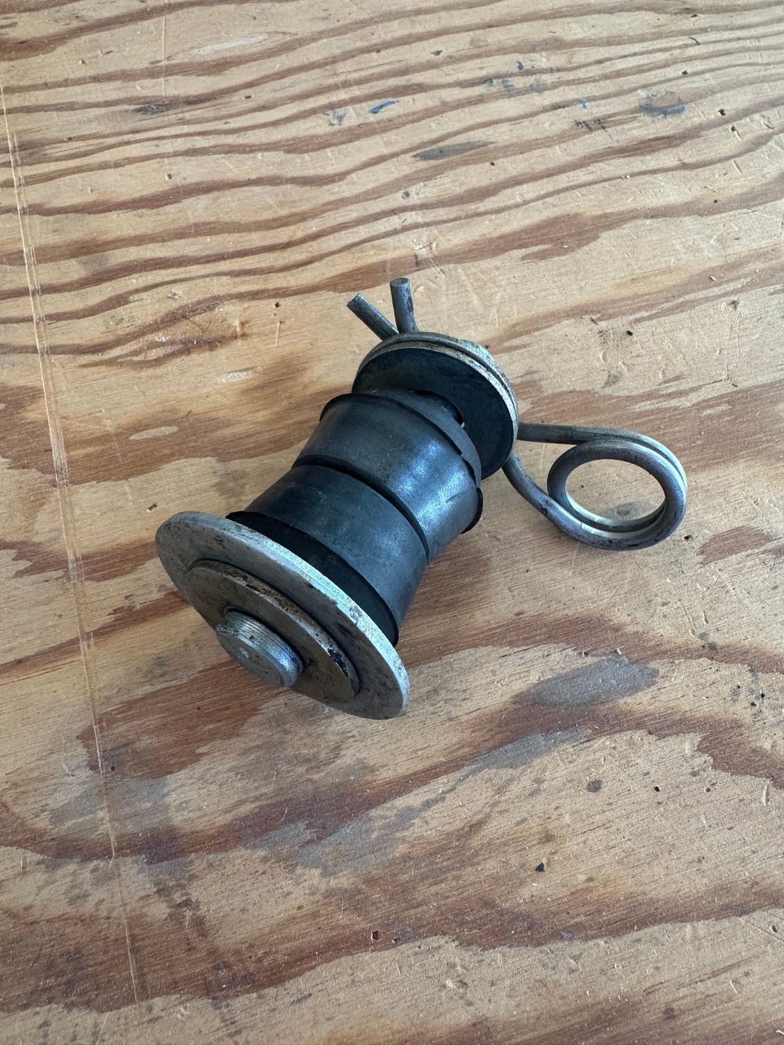

Sway Bar Disconnects
My plan to use the selectable length clevis pin seemed pretty good when I first measured the existing bolt inside the end link to sway bar, but once I removed it, I realized it had a large shoulder to fit snugly in the bushings on the end link. the clevis pin was much smaller than the hole in the bushings. My first thought was to take the original shoulder bolts & have a machine shop drill a hole in it for the cotter pin to slide into, and I might still do that at some point. My solution was to wrap the clevis pin in several layers of Gorilla Tape. This sounds pretty sketchy and I was just trying **** to see if it would work, and honestly it's very solid; i have done about 100 miles with this as the solution & everything seems perfectly fine.
The end of the clevis pin was pretty small so I used a 1/2" zinc washer & a fender washer to give it the largest surface area & strength; and then used two 1/2" washers at the end against the cotter pin to make it very tight when its installed.
Works great, easy & quick to disconnect & have done some miles on the road & it feels totally fine; don't hear any bad noises or anything; I have the original bolts that I can drill out if i fell this isnt holding up but we'll cross that bridge later

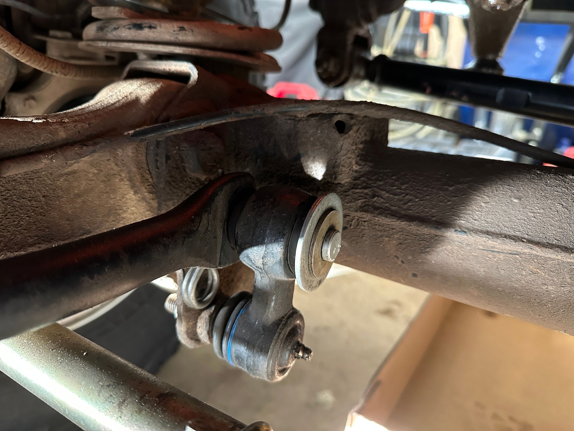

Sway Bar Disconnect with bushings on it
Sway bar disconnect apart with tape shoulder
Sway bar disconnect installed
