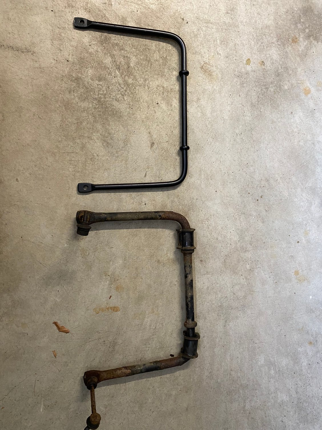

Hello,
I am installing some extended sway bar links on my 2004 D2 which I need to saw off due to corrosion. I purchased a whole new sway bar from an eBay dismantler for really cheap as I needed to replace the bushings anyway as the used some came with some. Anyway, I got the new bar in the mail yesterday but the diameter is much smaller That what is on my truck.
“New” bar is 3/4” or 18mm
existing is 1 1/8” or ~30mm
Other than the diameter it looks the same. So was I shipped a sway bar from an earlier Discovery or was there some reason for 2 different diameter bars? I do not have ACE nor was it removed previously.
The RAVE only mentions a 30mm or 35mm if you have ACE.

Confirmed that the donor truck was an SE so I think mystery solved. Non 7 seater trucks have a thinner rear sway bar than 7 seaters. I find this a bit odd as I think people or cargo back there, it’s all added weight to the rear.
EDIT: Confirmed it’s air suspension that makes the difference in the sway bar diameter. Thicker with air suspension and thinner without. Hope this helps someone in the future.
Picture of the difference
