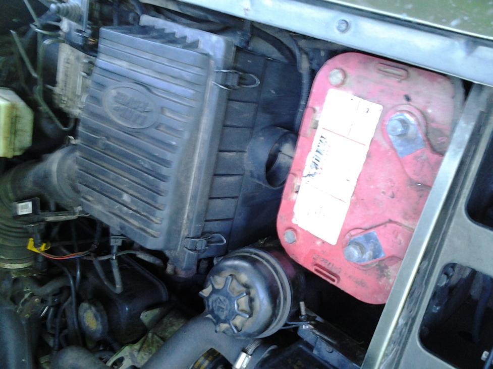

There shouldnt be a need for cutting/welding ect unless as previously ststed a snorkel is present. When i add my snorkel i will run the tube inside the fenderwell so there still wont be any issues. I should mention i had to twist the stock bracket with a crescent wrench to wedge between the battery and rad hose. Obviously this will rub plastic on plastic eventually causing A hole in the intake and p.s. resevoir simultaneously causing you to hydraulic your engine on the atf in catostrophic fashion. (Knew some theorist naysayer would go there so i beat them to it!)
