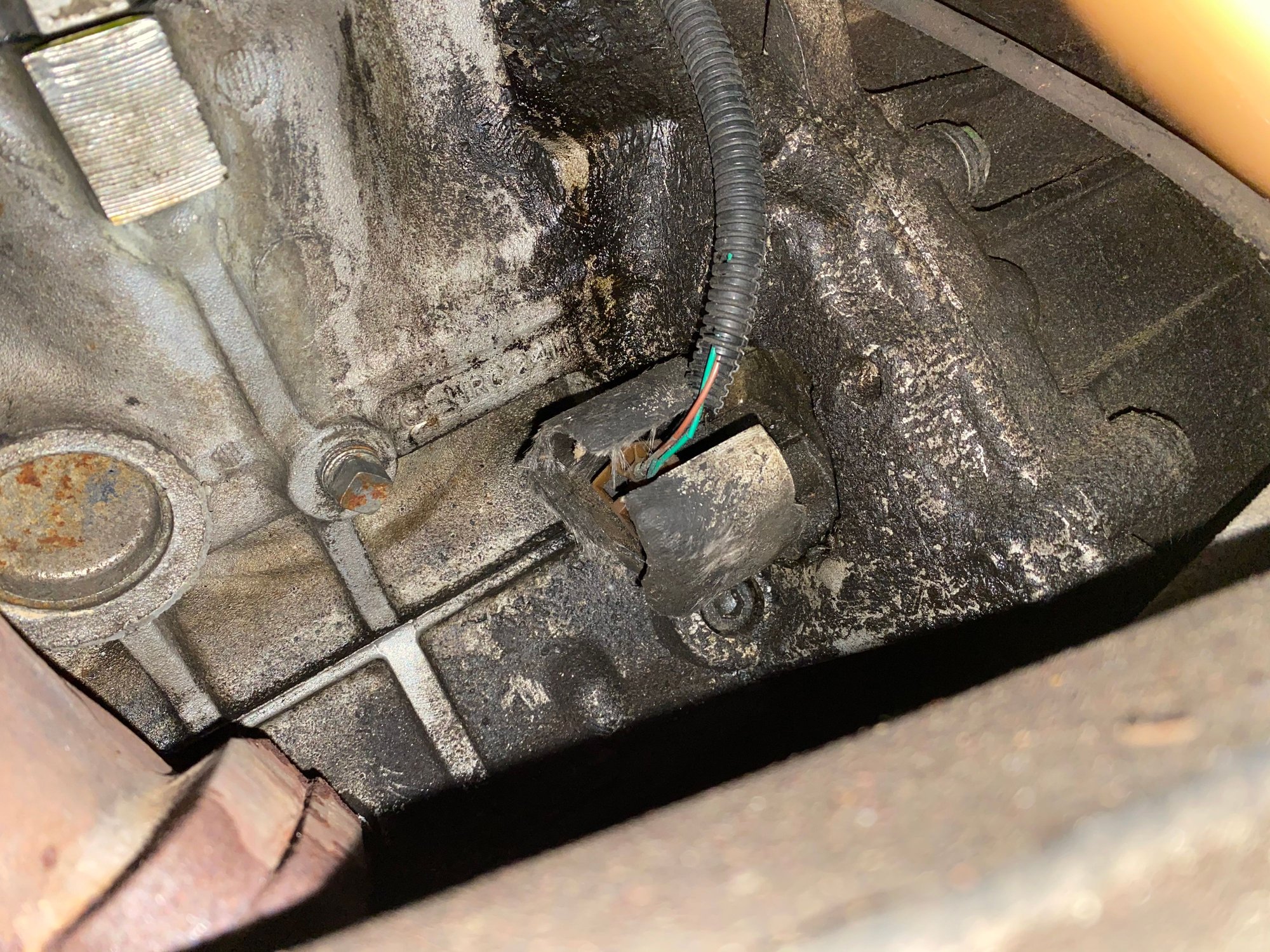

When I give it throttle it does stay on. I’ve been thinking along the lines of crankshaft sensor. I went out again this morning and it fired right up and stayed on. I left it running for a few minutes, then cut it off and tried again. Had the same issue. I looked at what I believe to be the crank shaft sensor under the car. The wires looked like they had been chewed on by some rodent, but I’m not certain it’s the crankshaft sensor I was looking at.

Yes that is the CPS, I would repair that wiring (same harness = fog light) heat makes the insulation just fall apart. If you give it throttle and it keeps running I would double check the TPS, MAF sensor plugs, also try to get an OBD2 reader and see if you have any codes.
