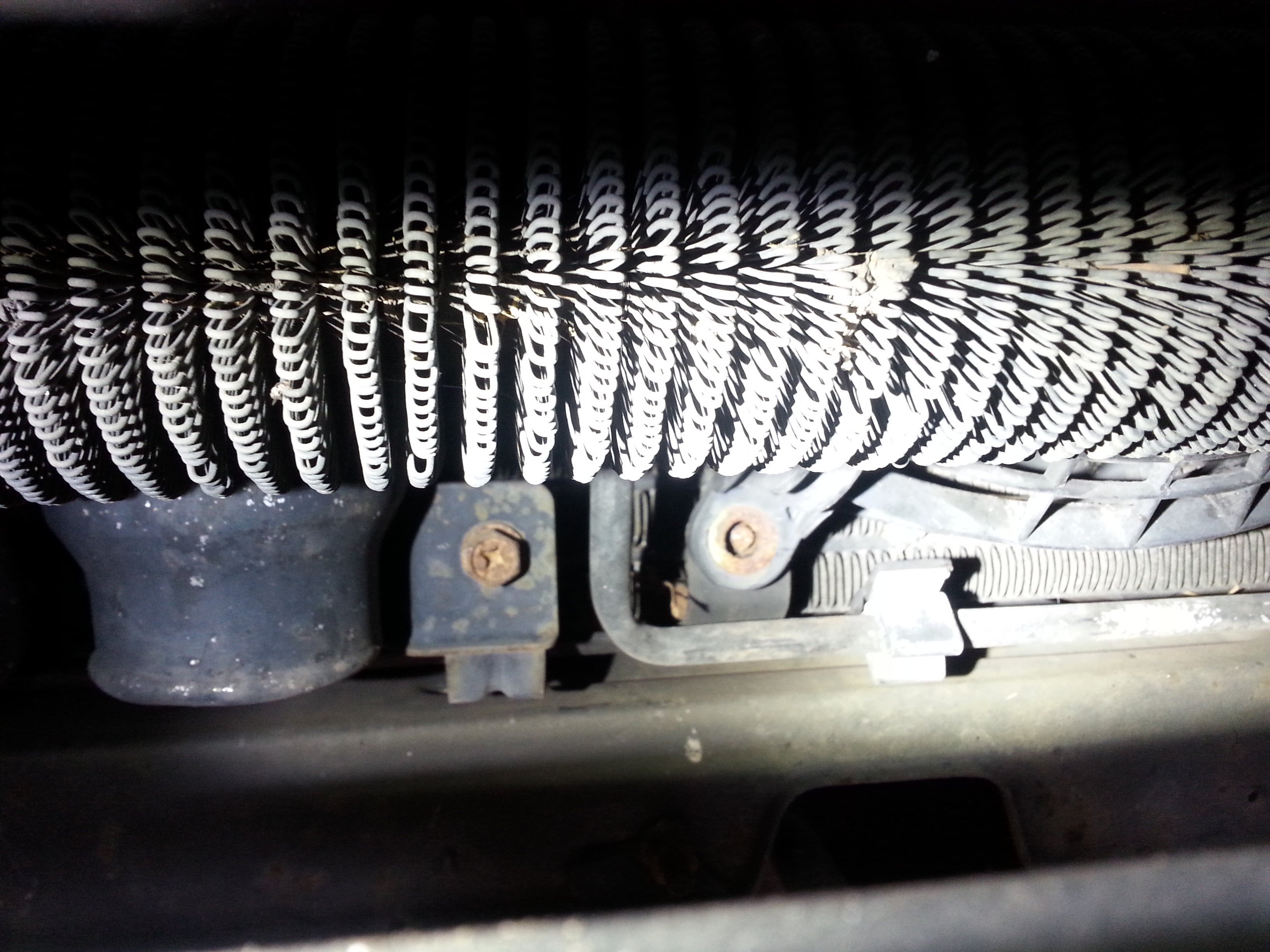

When I replaced the fans this spring a couple of the screws broke off (quite rusty). Figured three out of four per fan ain't too bad. So you might want to look to see if the screws are broken off.

IIRC the screw heads are 8mm hex w/ phillips slots. Can't remember thread pitch /style. They screw into either speed nuts or speed clips.
Like I said earlier a couple of the screw heads broke off but there was enough of them sticking out that they acted like little dowel pins.
Took these pictures yesterday afternoon. Quality ain't that great but HIH.
Attached Thumbnails Electric Fan mounting hardware for AC-20170720_163359.jpg   Electric Fan mounting hardware for AC-20170720_163407.jpg
