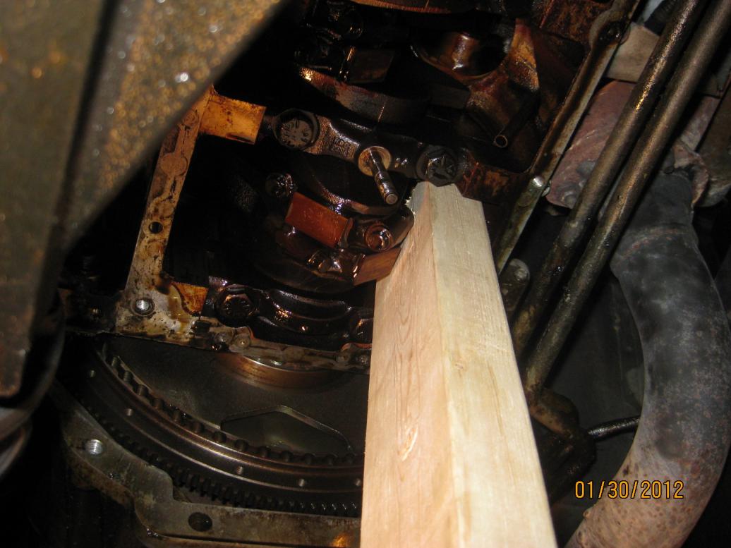

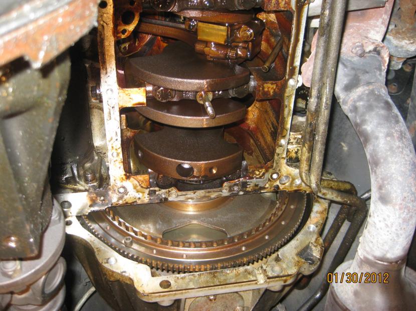

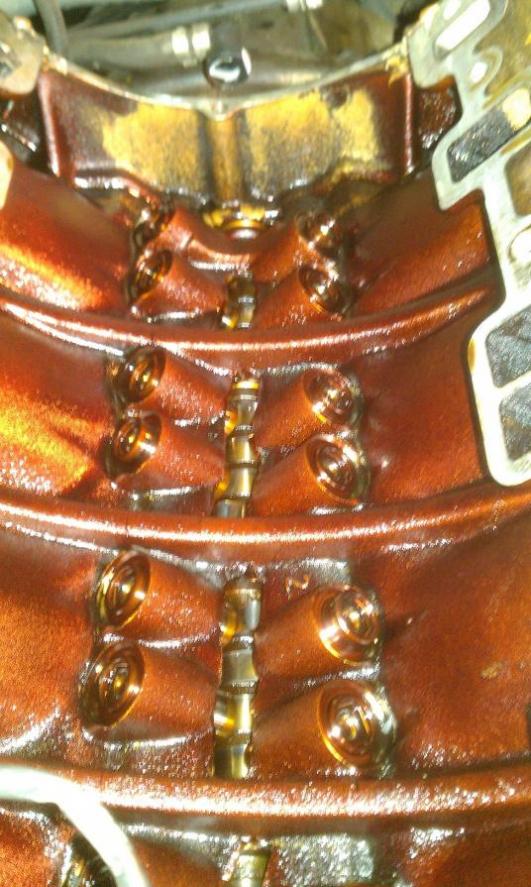

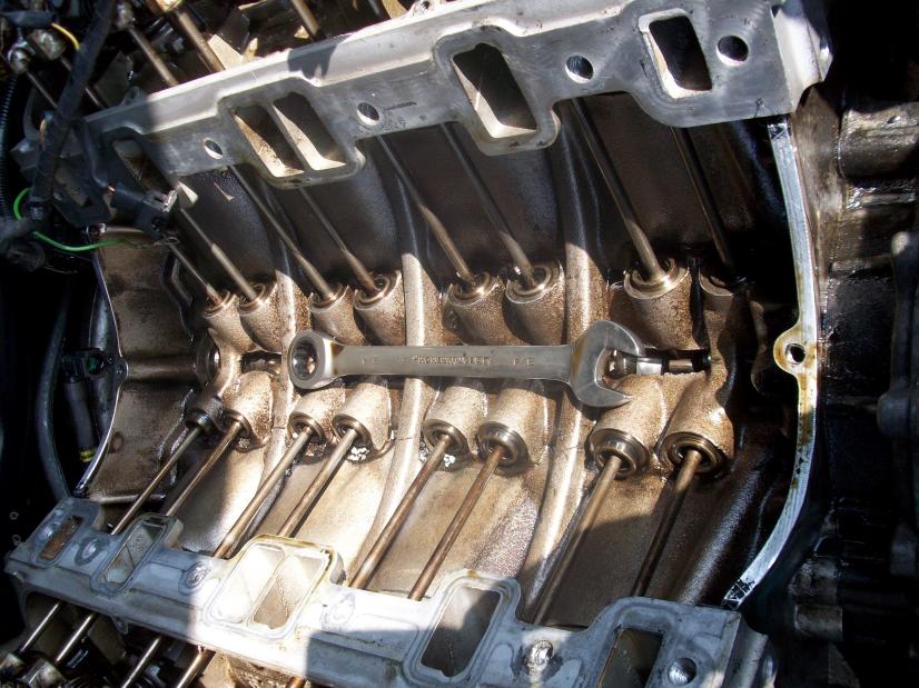

Both will help you, niether will hurt you, and the innards will retain that baked on look unless scrubbed with a brush in many cases. By the time you see it at the oil fill cap, it is a lot worse most other places. Baked on varnish does not solvent off easily with something that won't eat up seals.
If it did, you can bet that "mechanic-in-a-jar" would have before an dafter pictures all over TV and the web.
Pix of 190K rockers - Castrol and Rotella frequently serviced
Valley pan (intake had been done cheaply one before)
Heads - not so often on the oil changes
Valley at under 60K - this is what to expect if you are running hot and changing oil when you get around to it
Pickup with sludge and varnish buildup
Attached Thumbnails Engine flush ??????-100_0313.jpg   Engine flush ??????-03032011189.jpg   Engine flush ??????-eng-1a.jpg   Engine flush ??????-engine5.jpg   Engine flush ??????-modp_1011_02_o-ilsac_gf5_motor_oil_standard-sludge_buildup.jpg

more pix - change oil early and often. The oil change interval was selected by the marketting department to make the cost of ownership seem lower. When dealing with sales weasels keep in mind just how large a fib they are willing to tell to make their 2nd mortgage payment. It is not an ethical issue for the pros, but the junior grade ones have to struggle with it. (From a quota busting eight state road warrior raised on Zig Ziglar. It's never too hot to cold call.)
Mom's taxi service, milk runs to 12 errand stops, and extended high temp operation all work on the oil, along with cheap gas, infrequent changes, not changing filter, using cheap filters that stay in bypass mode too long, and watered down oil - all these things help with sludge and varnish formation.
