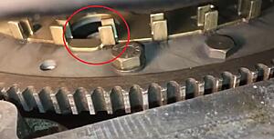

pull the inspection panel (moon shaped) and use a 'boroscope' of some kind. I bought one on Amazon a few years ago when I suspected my flex plate (turned out to be nothing). Video here...

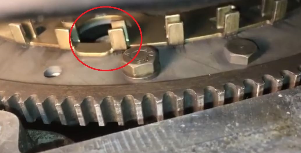

The trouble is that the flex plate is behind the 'fly wheel' where the reluctor rings are located. The only way to really see it is to sorta look past the bolt heads that secure the flex plate to the torque converter.
Here is what you'll see when you remove the plate... i've circled the bolt head you'll need to look past.
Walt, thanks for the photo, very helpful.
