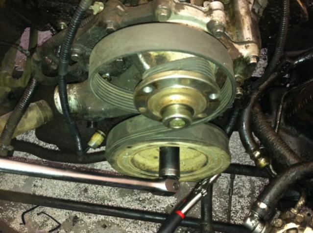

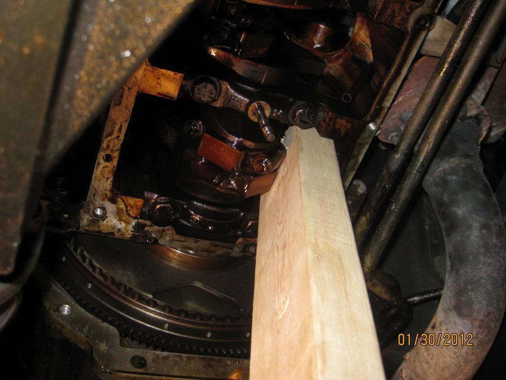

Other options include - breaker bar with socket on crank pulley bolt, brace against ground, bump starter. And pix - old belt wrapped around, and just putting some good wood on it.

Everything is out. BTW, the 2x4 idea was great and worked like a charm!

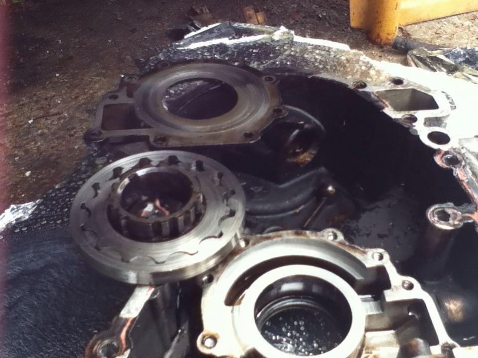

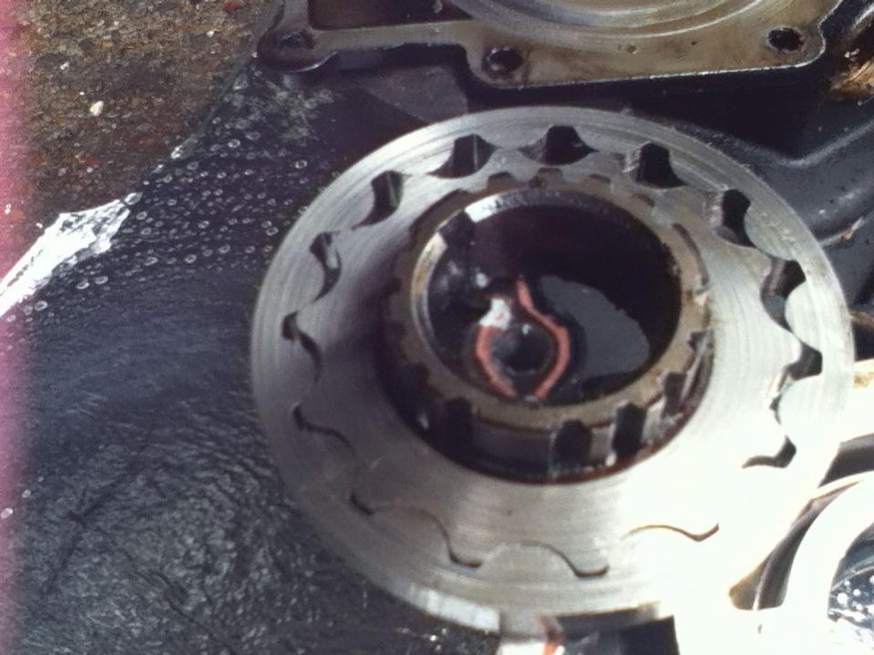

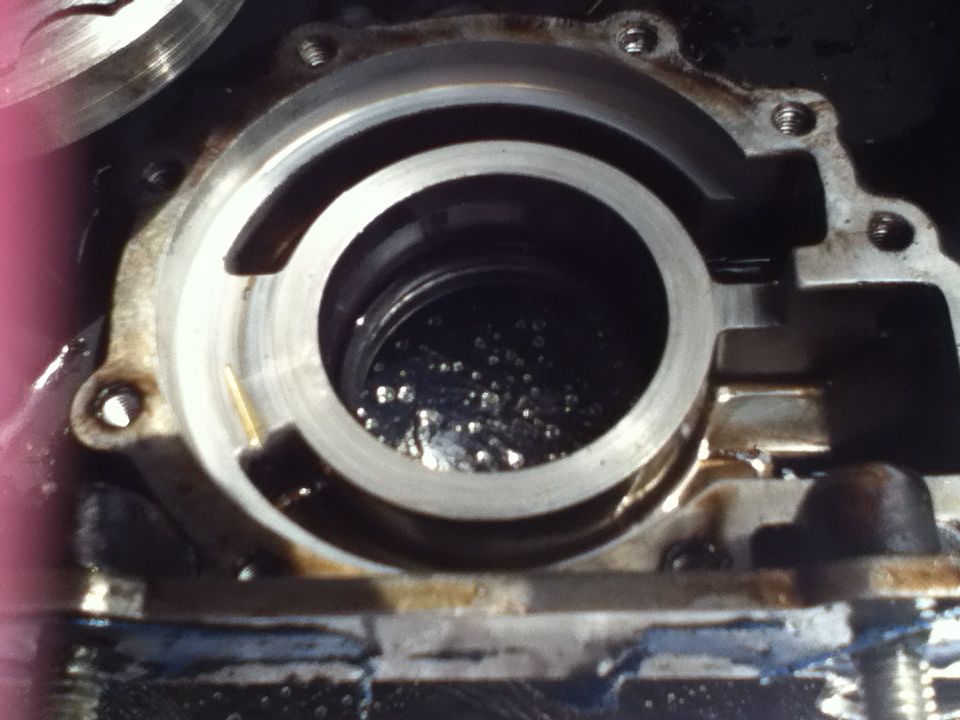

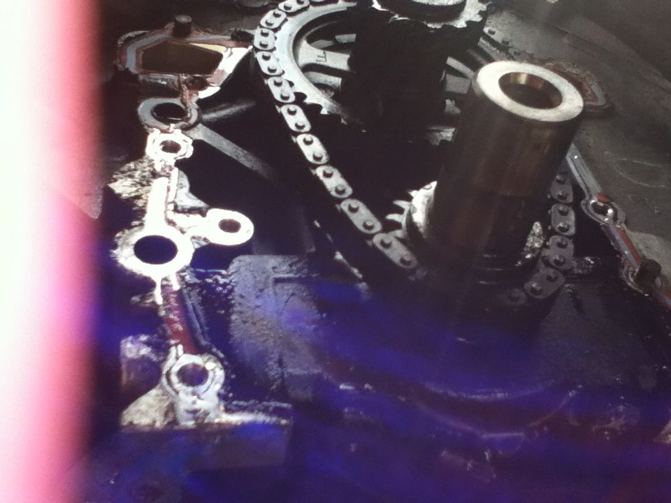

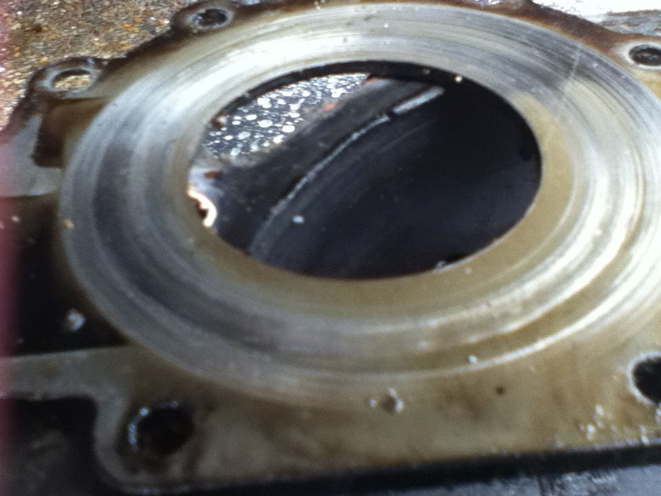

The timing chain seems to be really loose... floppy loose. I shot a video showing it and the scoring on the oil pump gears and faceplate.
Plus here are a few pictures.
I guess the next question would be should I be worried about the amount of scoring I see, how would I address it if need be, and is this amount warrant a new cover or? If a new cover, It would seem to me that would be the end of the engine due to it's cost...

How many miles are on it?
I cant say anything about the scoring, I have no idea if that will effect oil pressure or not.
If it does I would not spend the money on a timing chain unless you were also replacing the front cover, just put it back together and drive it while you figure out what you want to do.
If the scoring makes no difference then replace the timing chain.
I do not know if it is worth it to buy a used front cover or not.

Says 150k.
I dropped Will Tillery an email about it also, asking his opinion and of course to see if he had a used cover. The scoring is the ONLY thing I see wrong with the gears and the cover so it must be the issue... But I'm not going to drop 500 bucks on a new cover for this engine...

Yes, low pressure. Oil light on when at idle and nasty ticking which can be heard here....
95 Land Rover Discovery 5 Speed. - YouTube
I'm also looking into the option of polishing out the current scoring, I need to check to see if the damage is within the wear specs tomorrow.
