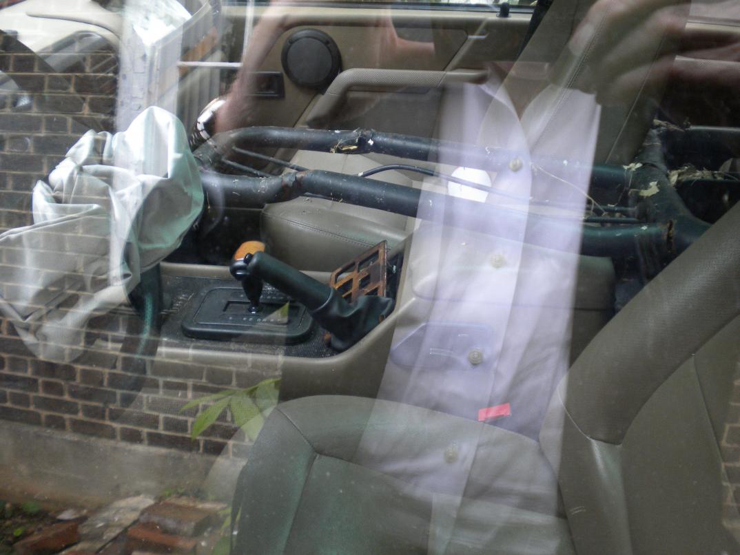

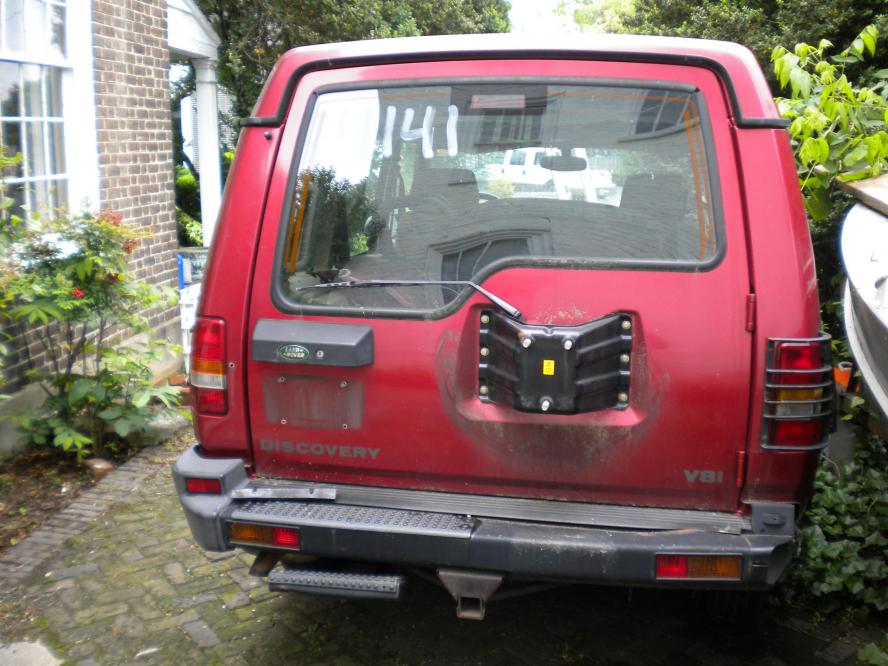

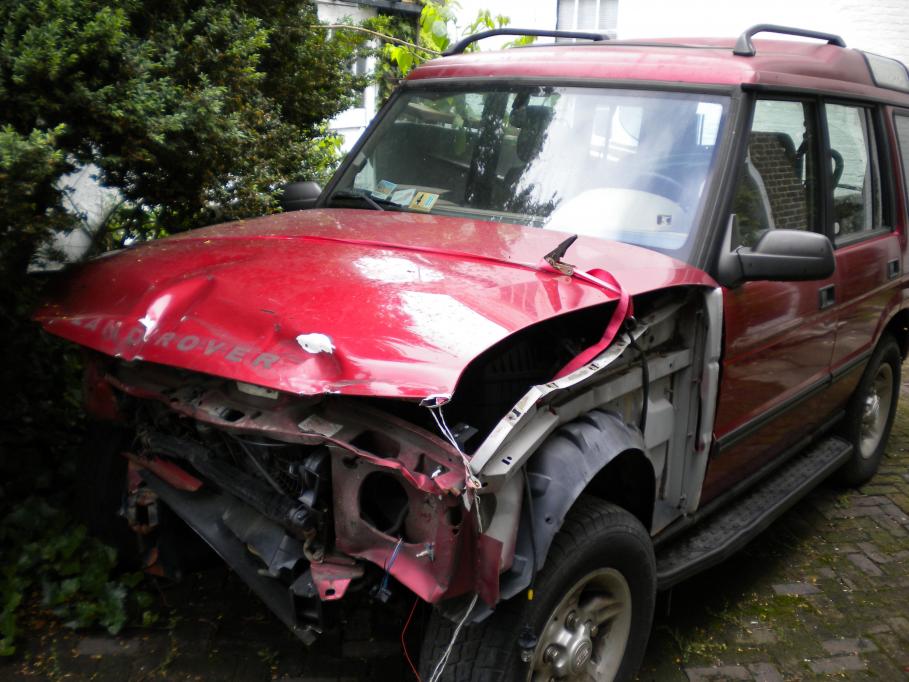

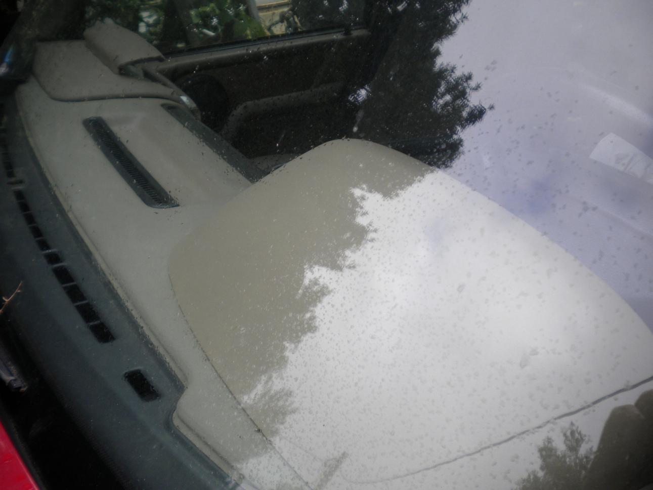

I found a 97 se7 yesterday that hit a wall, front totally destroyed, seems to have a really nice interior and an from what I can tell a perfect dash, I think I'm going to work out a deal to try and get parts from it.

I would suggest you try to see how much they would sell the whole 97 as is, then use what you need, part out what you can and sell what's left as scrap.
I have a local place here that prefers to sell entire remvoed engines and the tranny with T/c still attched a lot cheaper than I have seen either one availale anywhere else. For less than the price of that new cover I get all three (engine, tranny & TC).

I know what he wants for it as a whole and he's about 400 to high. I'll let him sit i=on it for awhile. HE's wanting almost as much as a running driving truck! Things frame is torqued also... With that kind of damage, I can imagine what the condition of the engine etc are since it was running during the impact...

As for the donor truck, as long as it runs and goes into gear fine it should all be alright.
The inertia switch would have killed the fuel pump, so no engine overheating.
If you start it and it rattles and makes one hell of a racket then look really close at the front of the engine.
Tweaking the frame in a accident like that the whole engine and eveything will move with the frame, broken motor mounts etc. are the worst that should happen.
