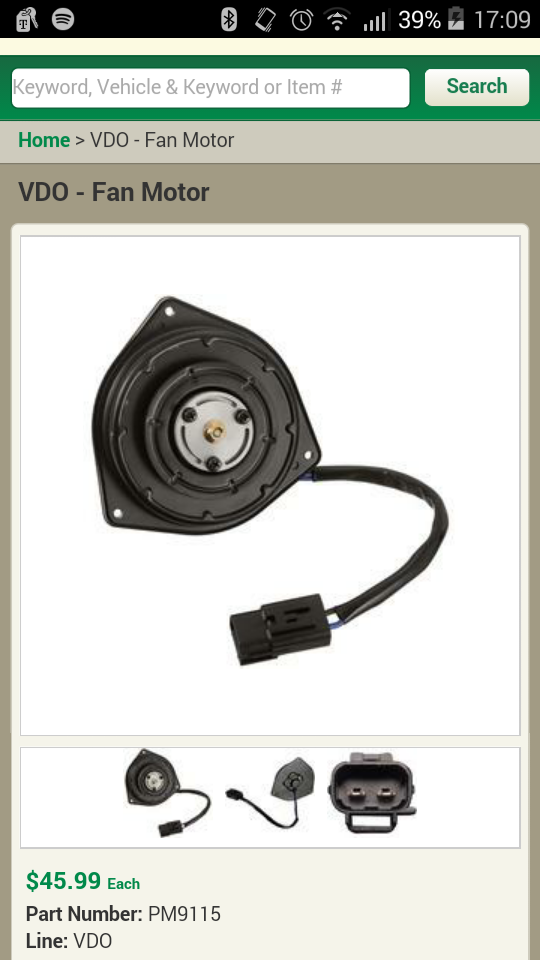

Ordered this ac condenser fan motor today from o'reilly auto parts. Attached is pic with info. 93 Corolla. Almost done putting my engine back together. Radiator fitting will be last..

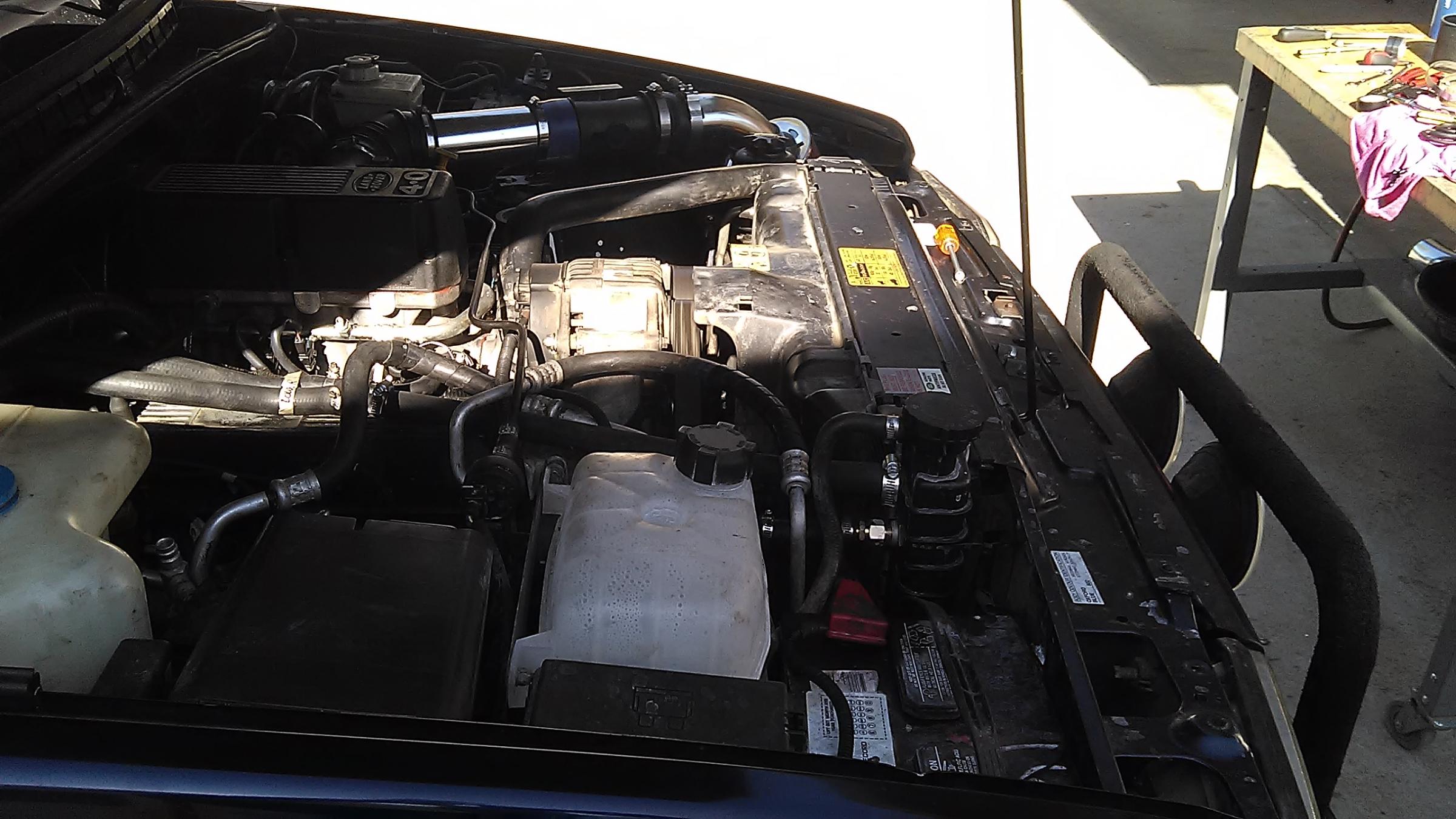

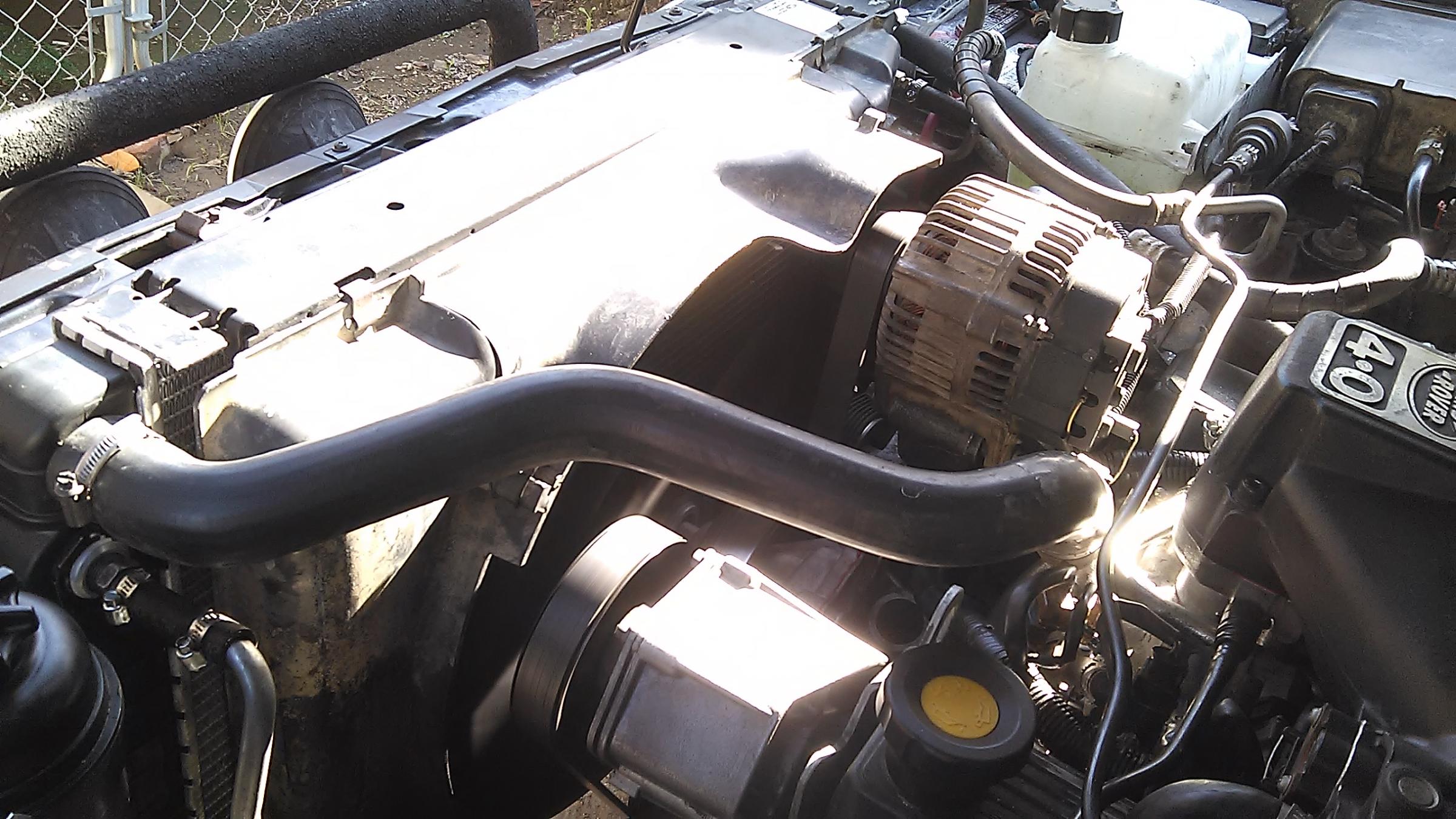

Here the pics as promised. The zip ties were used to mock/hold the rad in place while I secured it with the brackets. Left them on just because. So far so good. She's running at 180-185* with a 195* t-stat so I'm happy. No stupid LR wheel up purging air out of system anymore. No leaks, no issues. Pretty straight forward and pics are self explanatory. Still needs some cleaning up but good for now. Smog tech didn't even notice it wasn't the stock radiator. Lol.
*Note* fill neck didn't clear and couldn't sink radiator deeper in lower support because lower hose wouldn't clear. Had to dimple the hood a bit for hood to close. Going to put a hood vent there and on the opposite side to match.

Looks great other then the need to mode the hood
Please put a parts list all in one spot
With read app, lower hose app and the fittings for cooling lines in case someone else wants to follow suit
I wonder if the range rover hood would clear it?

It wasn't that much that it didn't clear. Dimensions didn't take in account for fill neck... Very pleased with outcome tho. No clue on part numbers. I posted the radiator info already and everything else was pulled off a late 90's - early 2000's GM truck/suburban (lower hose and radiator coolant line fittings). The LR upper hose fit the GM rad. Lower hose from said GM truck fits water pump fitting. Just cut to size. I used generic hyd hoses for adapting the cooler lines from truck to fittings and bought generic heater hose from o'reilly auto parts.
