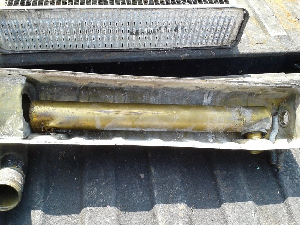

Well plastic rads fixed and back in seems OK with GM clutch will revisit all this later
Here is the inside of my original copper one never rodded, we took oil cooler from here to fix the other one

is that 5 cores???? holy.

No 4 cores dimpled for 5 though
