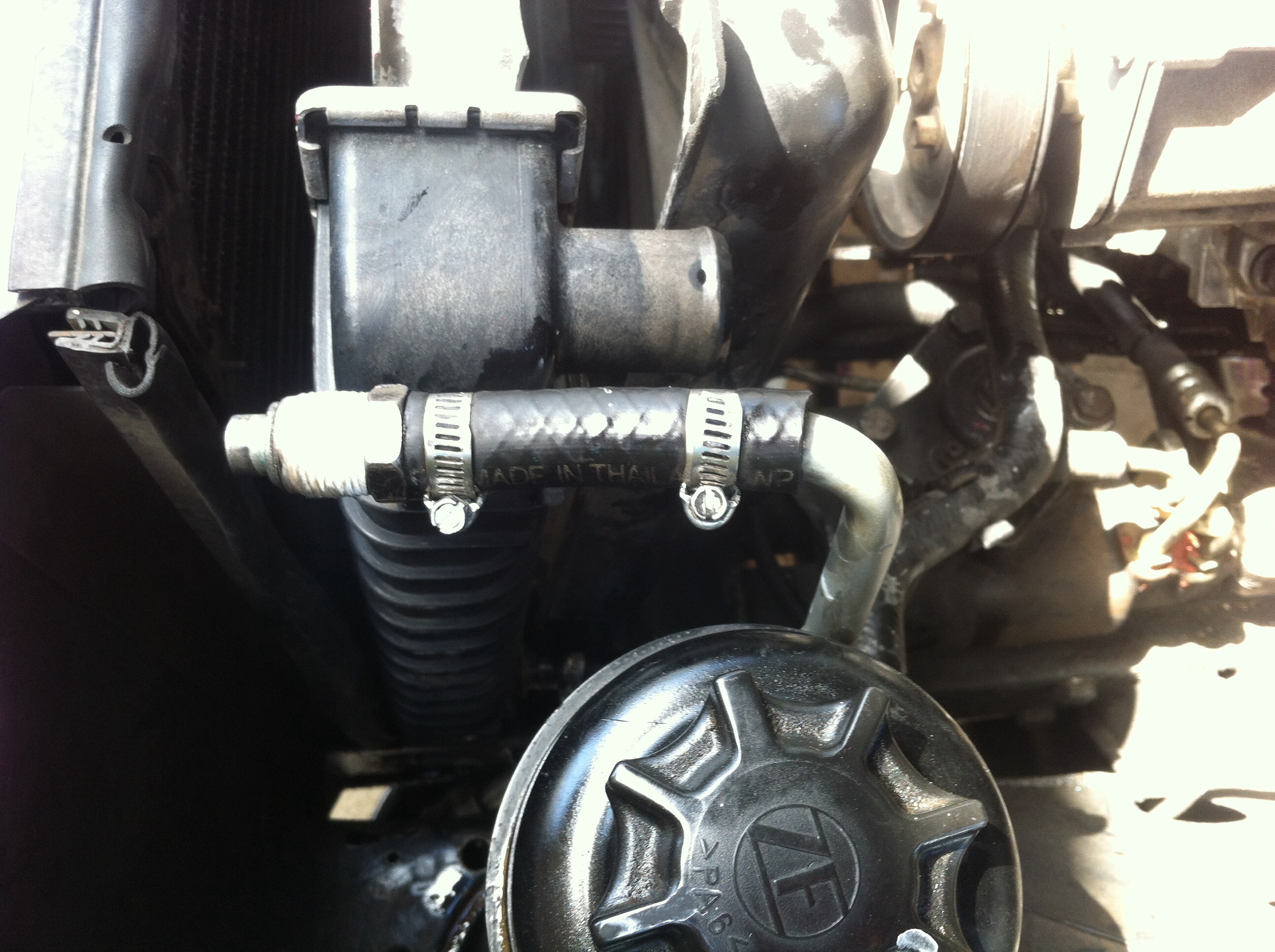

If you read back some pages you'll see I cut the Rover coupler/fittings of from the cooler lines and adapted the GM coupler/fittings with hyd hose and good hose clamps. I did flare the ends of the cut Rover lines for good measure. I'll post more pics later. I didn't use a reducer or anything, just the GM fittings.

Well I guess I'm not wrapped around the axle about the lines... No reducers used on mine. The new GM rad did come with some for one side but I didn't use them for long. Hacked off the couplers/fittings with about 4 inches of the metal tube still attached to it from a GM truck. Hyd hose, hose clamps and voila.

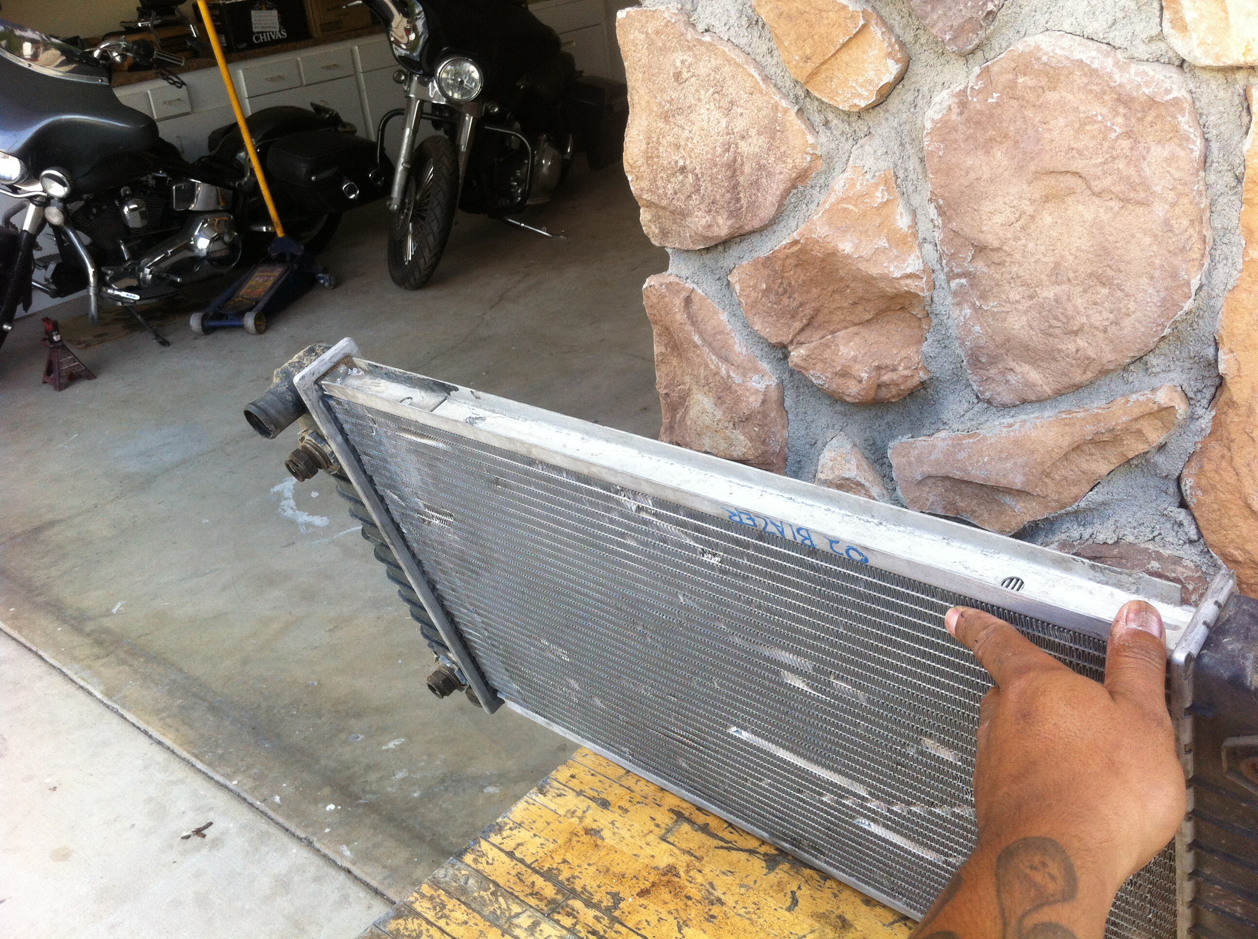

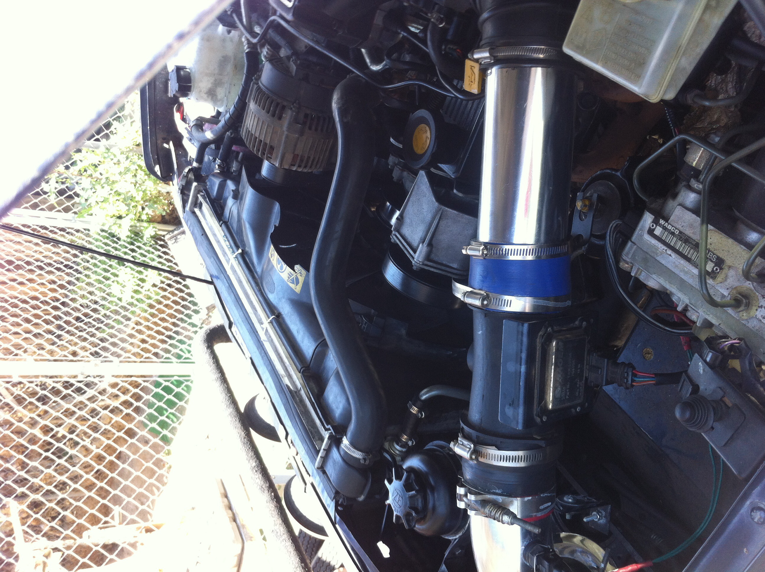

Correction, the radiator I just bought is a 02 S10. Tag said something different. Here's pics of it mocked up. I used the same brackets as before (side tanks are the same). Zip ties were use to hold it in place while I adjusted the brackets. I leave them on as added security. The top fan shroud piece has .030 safety wire now instead of the zip ties. The core on this S10 rad is almost twice as thick as the longer/taller GM 2500 one. No leaks and running as cool as a ocean breeze. Electric fans don't ever kick on...
