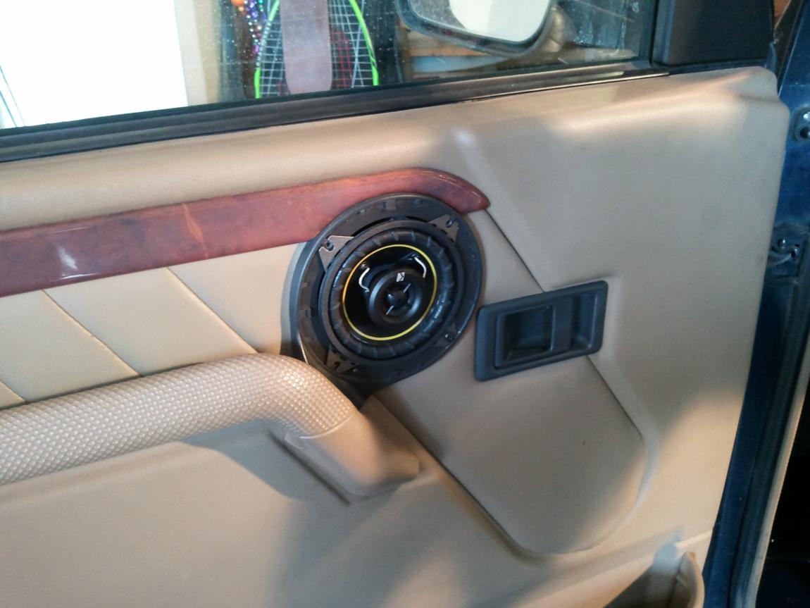

I grew tired of the buzzing in my rear door from blown subs. I also got sick of the CD changer not working, and the tape deck purely SUCKS for the ipod converter thingamajig. So, I tore it all out. Front 2 door speakers, 2 rear column speakers, 2 subs, radio, and stock amplifier.

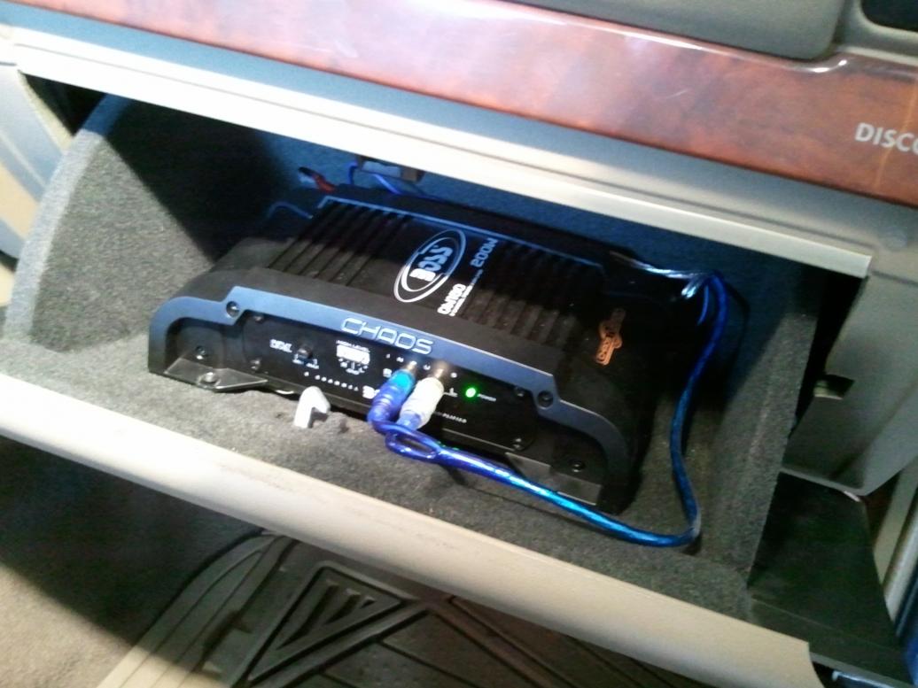

BOSS CW150 CHAOS WIRED 200 Watts 2-Channel Power Amplifier:

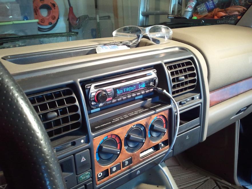

Those 4 are powered by a Sony Explode 52X4 head unit my brother gave me. I use the AUX-in jack for my iPod.

The kickers are a SNUGGGGG fit in the front doors. Magnets are big. You may want to remove the foam block behind the stock speaker to help - but they DO fit. No cutting/drilling/or even cussing required.
The Pyles DO NOT FIT in the front doors - they are for the rear. I would have got all matching speakers, but I was just playing around trying different brands. They fit with no issue in the rear.

If you're bypassing the stock amps (I did cause I fried them trying to push the new speakers with them...) you'll have to run wires. JOY!!! I ran wires from the new head unit to the outgoing lines of the stock amp. EASY AS PIE. I put the Boss amp in the glove box. THere's normally crap in there anyway... this makes running RCA/REMOTE lines from the head unit easy. Power comes right through the firewall where the ECU lines are. And the ground is right under the kick panel. I ran new speaker wire (hefty) from the amp to the back, as I didn't feel like splicing more crap (there's one channel out from the amp, to the rear amp that splits into 2 channels... weird).

Oh - I removed and re-used the stock grills for the front doors. Don't want any riff-raff F'ING up my stuff.

I used the metra harness for the power.. Wired the speakers manually fromvthe radio to the old amp harness.

The head mount looks really clean. What did you use for a DIN shroud around the head mount, or did you fabricate something?
