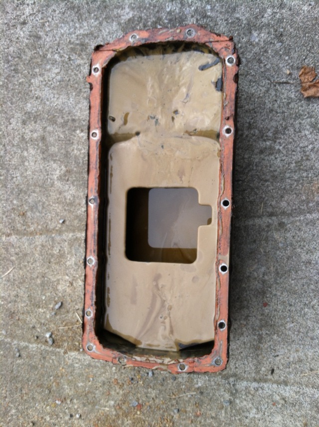

YUM!!!
It's actually not as bad as I thought it would be but I'm glad I pulled it off.

Is that RTV on the oilpan? if so it may have been off before.
Originally Posted by green-lantern
YUM!!!
Yes, it appears the head gaskets have been done before. I'm pretty sure somebody has removed the pan.

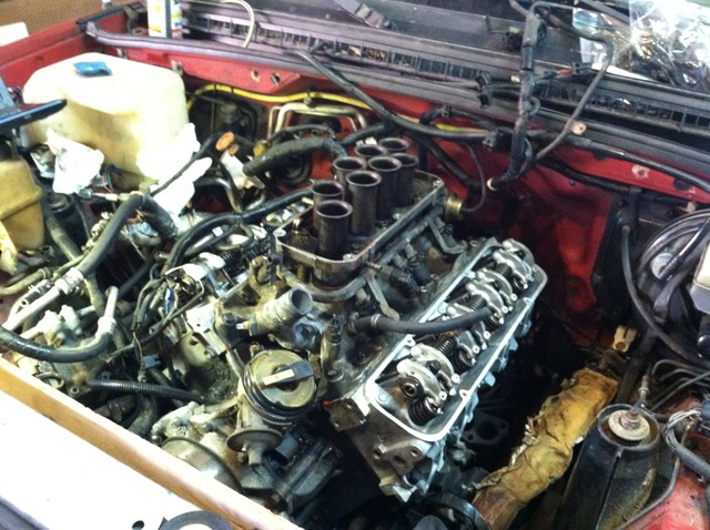

Starting to look like an engine again.......too bad there's a F-ing socket down in it!
I've worked on cars for over 30 years and I've NEVER dropped anything down an engine. Bought a magnet to try and get it out but I couldn't get it out. I'm so pissed! I had to walk away before I took a sledgehammer to it and called the scrap yard.

Where did it fall in? You know it's a Rover right? Your gonna pay for it one way or another....... The curse of Lucas is upon you.
Tom was saying to toss in a 4.6L crank and rods while it was apart...... He did and is saying it's worth the swap. (His rings FINALLY sealed.....lol.)
Oh yeah, nice looking engine...... Too bad we can't leave the trumpets uncovered, actually looks like it's got some guts. Looks like an old fuelie......
