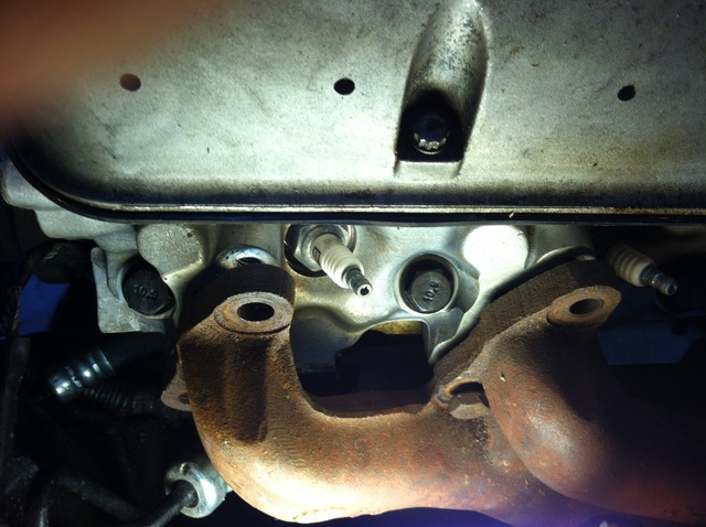

Well I cant believe this but now the drivers side exhaust manifold will not bolt up! It doesn't fit anymore. WTF?!?!? Could the head have been so warped that the bolt holes have moved? I've tried two manifolds and nether will bolt up. Only thing I can think to do is drill the manifold holes out more to try and make them fit.

Well I just measured between the top two furthest bolt holes on the head and compared to the manifold it's 1/4 inch off How?!?!?! Why?!?!?!?!
