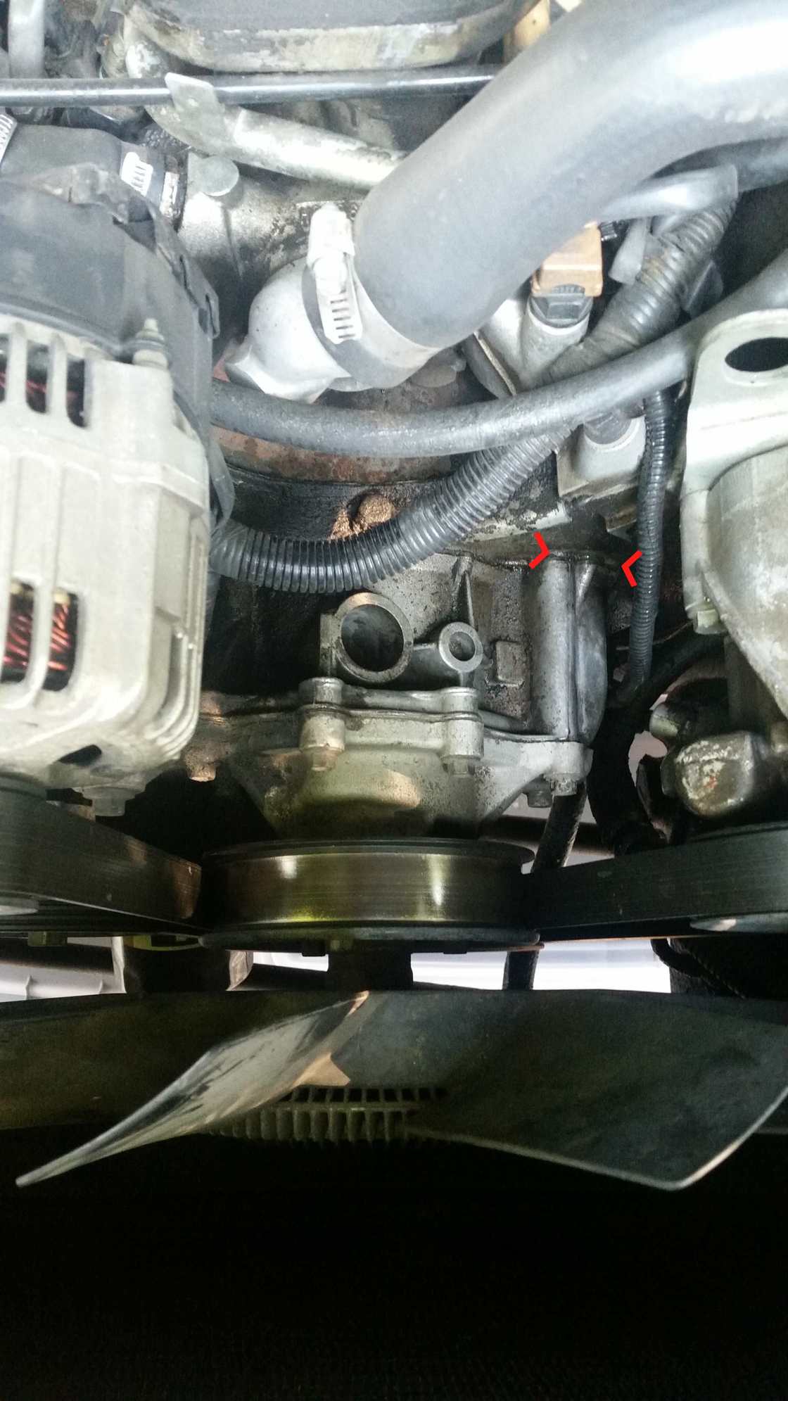

Thought I had a water pump leak in the rover. Ordered parts. Got stoked on a little Saturday project. Closer inspection = front cover also blew a hole too. Not prepared for that. Been reading RAVE (which I believe oversimplifies this process) and searching up some threads here. Sounds like it's a do-able project, but requires much more parts and time than I'd initially thought.

Do you HAVE to replace the cover, too? P/N ERR6438 ??

you said it has a hole in it...?? where, pics?

Oh. My bad... the cover doesn't have a hole in it. I think it's just the gasket. It's leaking visibly right between the red arrows here.
