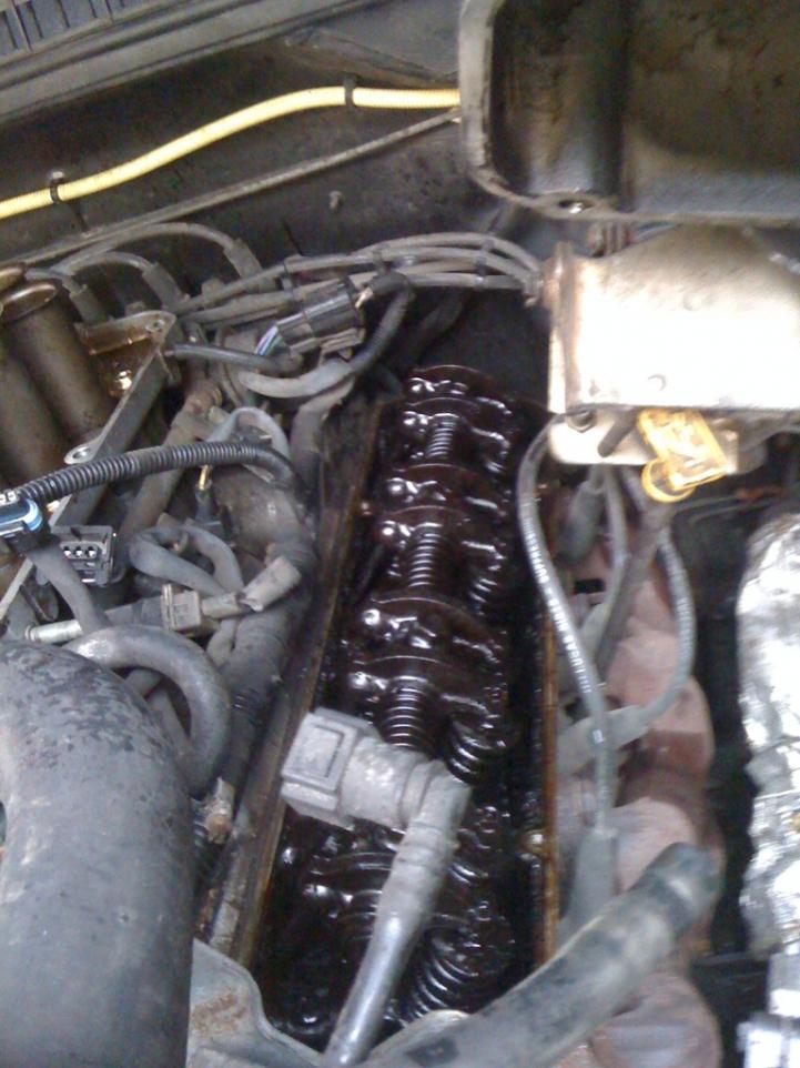

Your picture does not really show any sludge build-up, but I do like the idea of runing it with the valve covers off to see what that reveals. Also the idea of pulling the oil pan off and doing the oil pick-up tube and screen especially since you said you got a leak there anyway.
Then I would try what Spike said regarding the HD 40W Rotella and see what the results are unlesss the first test showed a significant problem.
