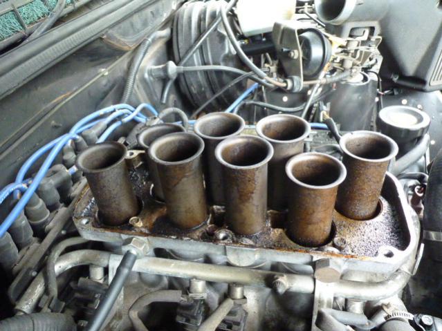

This is what is inside the intake. If you have too much gunk, from plugged up PCV system and previous owners that did not maintain things, then you may have more than Sea Foam can handle. I have SeaFoamed at least four times. This is what I found when I started the HG job. The PCV line is that bottom left.

Your choice. Depends on how dark oil looks. If still clear the filter is getting the gunk.
