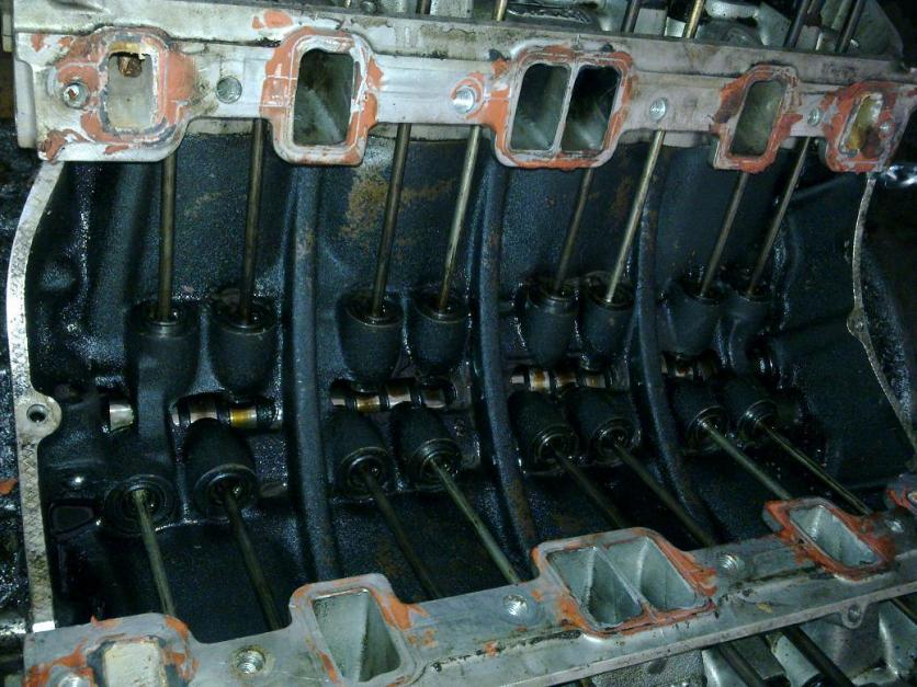

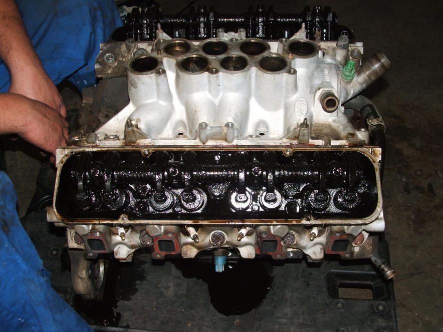

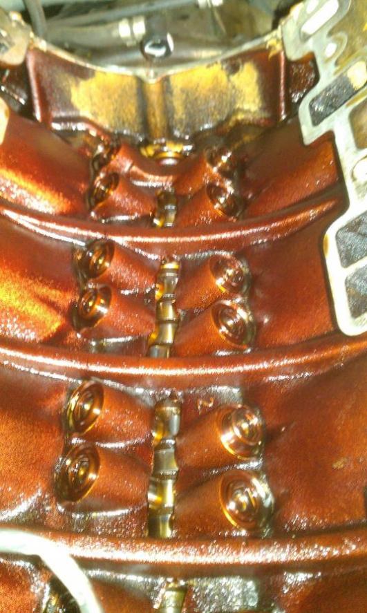

Actually it is a Buick design from the late 50's. You'll be right at home.
1 newton meter = 0.737562149 foot pounds for conversion.
You'ld want to look at the valve train, might have rocker arm problem, etc. Or lifters.
The four corner passages are the coolant channels. The lower edge of the valley front and rear are like a lip seal (not part of main gasket).

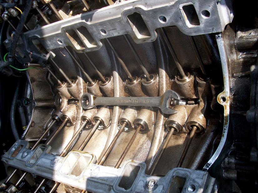

Keep up with all your tools, this one pix shows a wrench left behind that was a souce of "the tick".
Having some carb cleaner to clean up the intake and PCV system might be handy. Poke a rod down the oil galley drains when covers are off if sludged.

i am hoping I don't open it and see a bunch of sludge
ok so by the look of the one pic i need to use adheasive between the new gasket and the engine, do I also need it between the gasket and the intake?
looks like the usual places along the front and back of the engine and the 4 corners where the heads meet the block

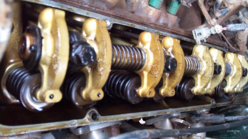

THINK I know what my valve tap is, the last rocker on the pass side ( where the noise comes from) has excessive play and the small pin tip where it contacts the valve stem appears to be driven completely into the rocker arm unlike all the rest on the engine
engine is nice and clean inside no chunks of crap like i was concerned would be there, everything is just a varnish color
