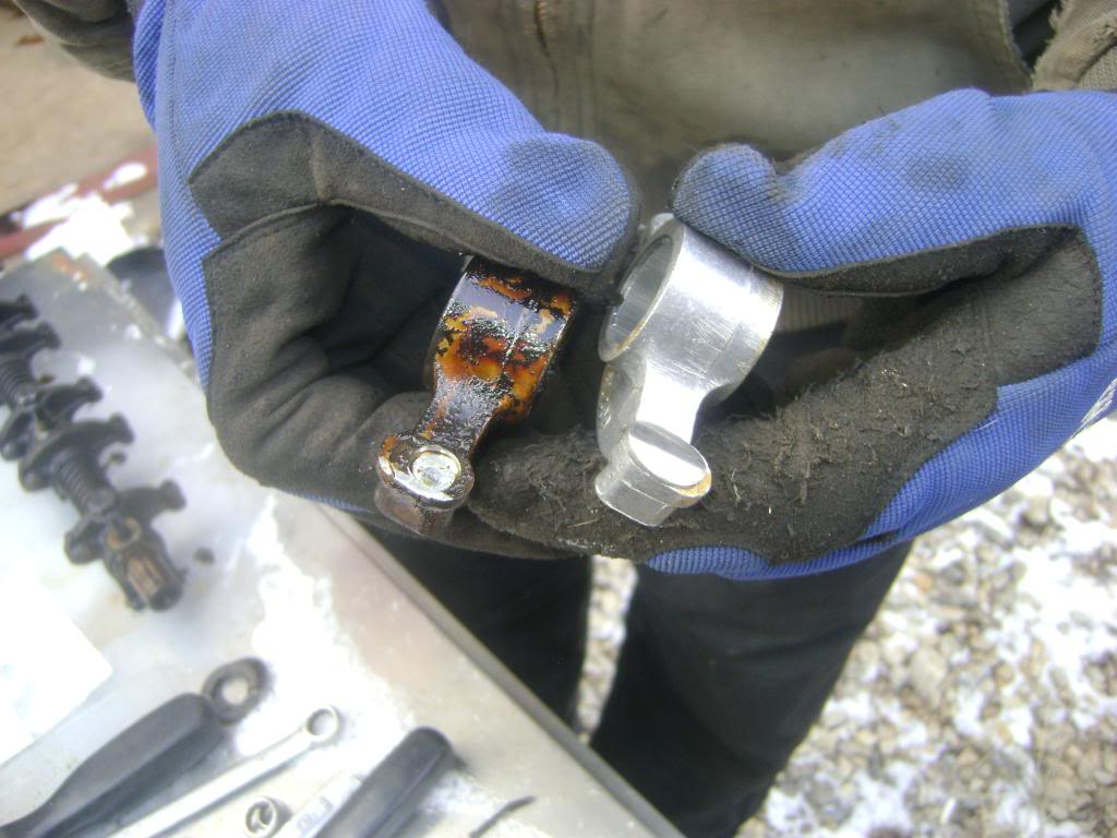

well unknown to me the rockers are left right per cylinder not left side of the engine or right side so of corse I had the wrong one come in and had to order a left today guess the last cylinder will have 2 new rockers, got a pick of the bad one just need to post it

here is the pic of the bad rocker next to a new one ANY IDEAS WHY IT WENT BAD? last one in the back on pass side which seems to be the common tap area

No real idea. But I'd take the rocker shafts apart and clean them up.
A brief soak in Purple Power will work wonders, but just not long, 15 min maybe, as it will dissolve aluminum if left in a long time. Don't ask how I know.
If you do clean them be very careful when taking them apart to make sure all pieces go back in the same order and same orientation. Use Lubriplate 105 assembly grease when reassembling.
You can clean the push rods too, but be sure they are reinstalled in the same lifters. Use a dab of lubriplate on both ends.
AB, and others, have Hylomar. I'm sure there's something similar, but I haven't seen anything as thin and reusable like Hylomar is.
I hope you removed the injectors as an assembly. If you removed the injectors from the fuel rail inspect the cups carefully for rust. I've had them where they would never seal again once removed and the fuel rail needed to be replaced.

thanks for the tips, I did not remove the injectors or rail from the intake
i was just going to lube the new parts with 15w-40 oil but i also have some cam instal lube left over from another engine definitly don't want to damage new parts

heat and lack of maintenance by the PO likely caused the damage....as antichrist said....clean them up good, fresh good grade oil and go from there.
