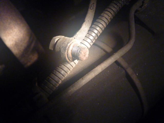

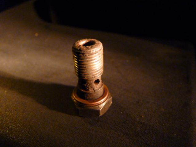

Pix shows the vent bolt for the axles, they get plugged up with gunk, and then diff oil is forced out thru seals into brake pad areas. They are attached to breathing tubes that go elsewhere, blow those out as well.

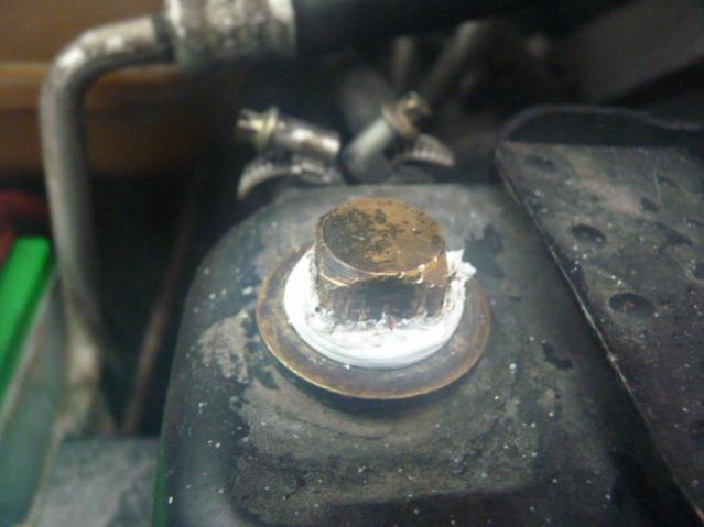

Pix of radiator is the $2 1/2" NPT plug you need to replace that plastic POS that came with the radiator.
