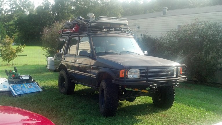

Have the Clemson fans gone to bed yet? (After beating Georgia on national TV)
AWSOME game!
Spent 13+ hrs tailgating and it was amazing!
