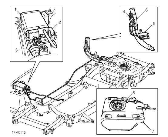

This used to happen once in a while, now almost all the time, fueling 98 Disc, gas pump keeps kicking off. There are a few lines on the Disc, to canister to engine, etc. Is the actual vent line in the fuel filler neck or the pig tail
coming out on the top side of the tank? I even disconnected that today and still gas regurgitates and the gas pump cuts off.

#4 Anti-Trickle Valve >> Fuel Filler Trickle Valve (Genuine Part # VUB502530 ) - Land Rover filler caps from Atlantic British

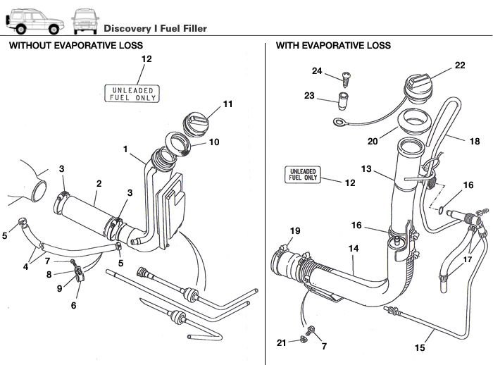

Yes, if your '98 has AELSystem. I was going off your original pic and that's an AEL setup. If you are unsure what you have start here > How To Identify The Evaporative Emissions Family Of Your Discovery 1
The pics are of the 2 systems.
Looks like the one on the top right. Going to check the numbers. LOL, as usual, mine is neither one of these numbers, but I googled my number and got this: https://landroverforums.com/forum/di...-family-21961/

Another part to replace/clean is the breather tube (#15 in the pic), the little check valve can get gummed up. > BREATHER TUBE FUEL FILLR DISCOVERY I w/E, ESR3868, RNS792 - Rovers North - Classic Land Rover Parts

I read something on that but there were no pictures. I have the one in the 2nd foto for sure, square canister.
