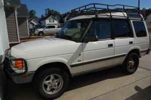

Guys this thread died for a bit because the one I was looking at was sold. I decided to be patient and hopefully it worked out. I found this on about an hour and a half away. She said the breaking system would shutter sometimes but not often and the abs light would come on at the same time. She also said it need additional break fluid added once a month. I assumed from my back ground that the seals on the master cylinder are done for. Worse case scenario I figure a sho[ will charge me 1200 to do this and give it a look over while its there. She said she stopped driving it 2 weeks ago when her daughters bf boght her a new car. Said the interior is perfect aside from the drivers seat indented from being sat in but no rips or tears which is rare. I offered to come get it for 1200 and she said yes so I'm on the way down to get it. I figured the parts alone were worth what I paid for it, hell the damned roof rack is worth 200. Heres the link I'm pretty excited.

Well I got it and all was as she said the motor was probably the best sounding motor I've ever heard over 100,000 miles. No knocks, no ticks or hesitation. It sounds alot like my buddy's completely restored wagoneer. I did hear something but it sounds like a small leak on the exhaust manifold gasket is all. Spike555 I didn't get your message until I drove it home almost 100 miles and I spent less than a 1/4 of a tank mind you cruising 70mph. This is the smoothest truck I've ever driven again its like the wagoneer, plently of power but not quick, very smooth. Let me know if I should pull that fuse asap and I will before driving any more. Problems are as follows.
1. The shutter in the breaks only happens when turning the wheel while breaking. You must be turning while breaking or it won't happen. Otherwise it breaks fine in fact she said she'd get me the dates and what exactly was fixed but the breaks were recently done. Also, no ABs light to be found unless that's the same as the Anti Lock Breaks light which is always on.
2. The "service engine" light is on.
3. The "Anti Lock Break" light is on.
4. Only when I'm cruising over 50 and I quickly let off the gas the motor sort of "jumps back " I guess is the right way to explain it. If I ease off the gas it won't happen or if I let off quickly while traveling under 50 it won't happen.

In the tech section there is a "how to" on how to find out the ABS fault.
Do that, then pull the under hood fuse until you can fix the ABS.
The "Anti Lock" light on the dash is the ABS warning light, there is a fault, but you already knew that.
If it is the "RED" Service Engine light over on www.discoweb.org there is a write up on how to reset that, it is a emissions service reminder.
If it is the "AMBER" check engine light then there is a trouble code for the engine.
Read all of the stickys ontop of the DI page, the cruise issue is a leaking vacuum line.
As for the power steering, check the belt tension as well as change the power steering fluid, it uses Dexron III in the power steering system.

2. Take it to autozone have the codes downloaded. Free.
3. See #1
4. See #2
5. You skipped 5.
6. Cruise is most likely vacuum. You have to turn on the cruise first, center dash, near you right leg, switch looks like a brindge or something... turn it on, if it lights, it's not your fuse.. once on you can set it. But vacuum leaks are very common. Simple fix. couple bucks of vacuum line.
7. Find a rover at the u pull and save... seats are cheap, or find someone with a crapped out rover...free.
8. Again, easy fix, take down the headliner... remove matirial and foam backing (hard brush, power sprayer etc... ) paint it, or have it recovered. Around me local guy will do them for 100 bucks and they look new when he's done.
9. Power steering should be just that... power steering.. I can tun my wheels with my pinky. If not, check the fluid. Is it whining or anything? if not, possible blown power steering pump... gets expensive fast. Can retrofit a chevy s-10 pump if you reuse the pully off the rover pump, direct fit, new about 80 bucks. Search threads here, guy gives actual part numbers etc for the chevy pump.
Drive the hell out of it. Have fun with it. Change the oil, every 3k seriously do it.. ONLY run 92+ octane fuel. Just do it. Sure the truck will run on lower... but your doing more harm than good... real harm.
Expect the seals to go. All the seals. seals suck on the rover. Head gaskets, valley pans, front and rear mains you name it, garbage. Plenty of guides on how to do all of them yourself.
Things I would do to it just for the sake of doing them...
Grease everything that's grease able. Check the fuel filler hose and the overflow hose... they tend to get old and will leak...pour out gas. (happened on all 3 of my rovers) Do a transmission service... filter and fluid. Not hard, but time consuming. Find and fix that header leak... again, gaskets are cheap. check every single vacuum line on the truck. Replace all of them. If they are not bad now, they will be soon... save yourself a headache and be proactive. lines cheap. change the fuel filter... simple job, takes 10 minutes, cheap... why not do it.
