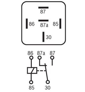

On a D1 the rear-view mirror has 3 wires power, ground, and reverse you will need to add a 12-volt automotive relay since the wire is small but enough to power on a relay for your radio head unit backup input.

Wire relay as listed:
30- tap power from radio 12v
85- ground
86- tap reverse wire (trigger)
87- power to camera.
