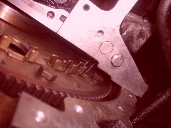

Look in at reluctor tabs? Bent ones could impact timimg. You still have the 10 inch vacuum at idle?

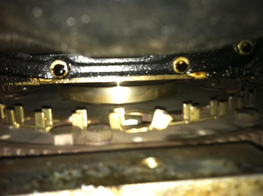

see Allbrit MG ROVER & Land Rover Katalog for how it links together. If can't see through slot, remove starter or Crank Position Sensor and all spark plugs, rotate engine and inspect with mirror and light. Or oil pan.
Cruise control gets its vacuum from a small electric pump behind front driver side head light. It does not use engine vac, and should not be cross connected to any engine vac.
