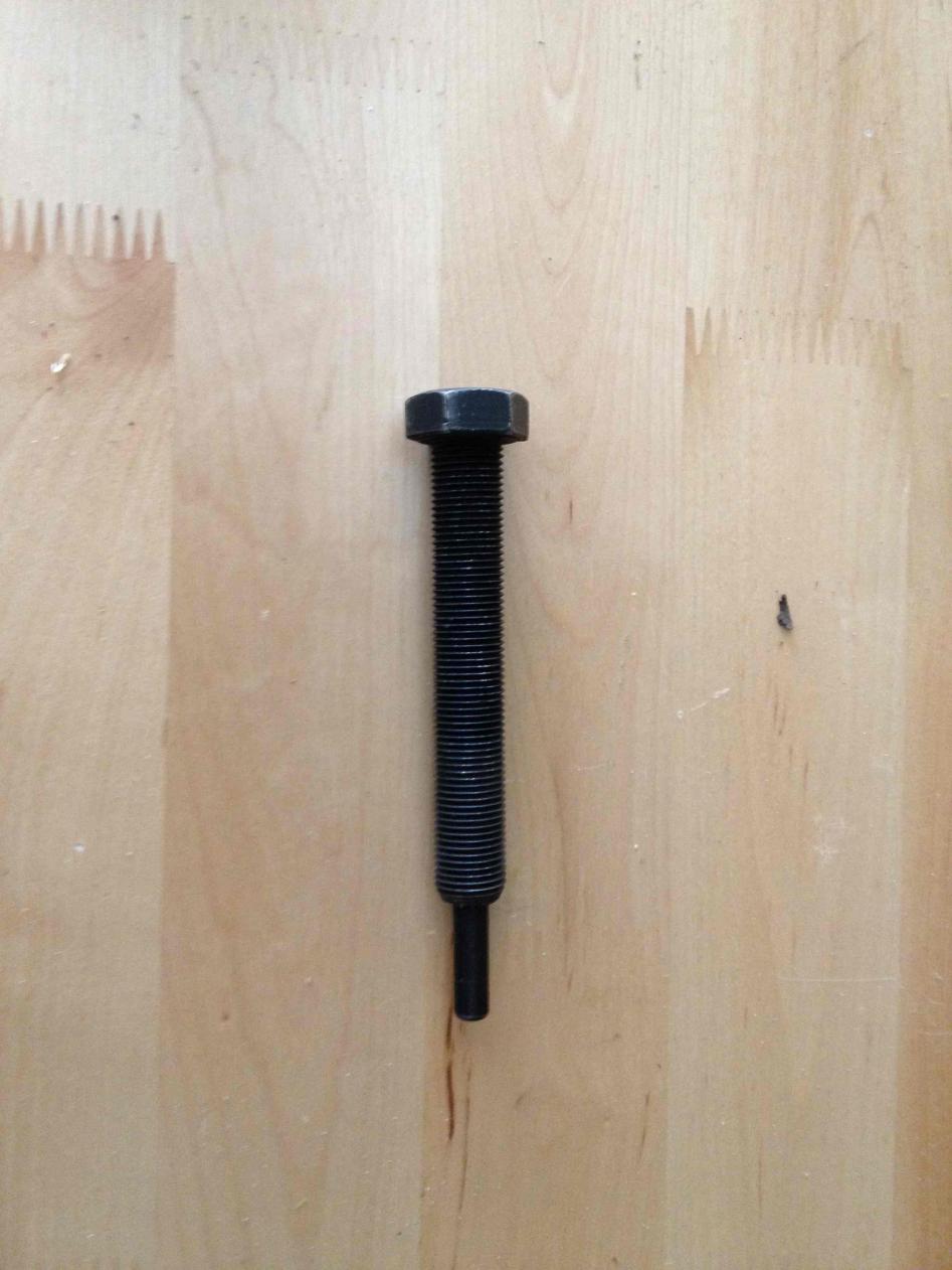

I have designed a lug nut cap removal tool. I will be happy to lend it out to anyone as long as they return it when done.
You merely put the lug nut in a socket, put a small socket on the end of the pin (you provide this) to keep from pushing the pin through the end of the cap and also provide a swivel.
Hold the socket containing the lug nut and drive bolt with the pin into the lug nut with an impact gun. Takes the cap off in about 2 seconds.
PM me if you want to borrow it. I'll ship it to you if you promise to send it back.

That thing looks just like the bolt for a chain breaker....
Nope, had it custom made at a machine shop.
