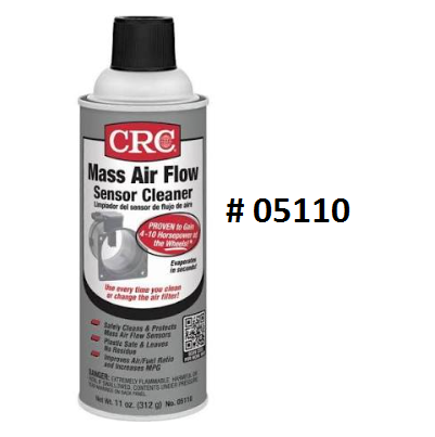

Normal, that's how they (ERR5595) look NEW
Just clean it with a good Mass Airflow Sensor Cleaner like CRC 05110 from any Auto Parts Store.
